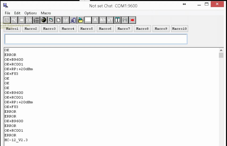

The module responds to "AT+A001" or "AT+A012" kind of command with an "OK", but attempts to query that command with the likes of "AT+RA" result in an error message.
My guess is that it is possibly ignoring commands from the earlier HC-11 module, for compatibility reasons. The module DOES NOT respond with "ERROR" when you issue "AT+A012", it just responds with "OK" but nothing else. Not sure if this helps at all, or makes matters worse!
EDIT: It does seem to be ignoring unknown commands, and sending "ERROR" for syntax errors in commands it does know. If you send something like "AT+ZZ" or "AT+OO", the module still responds with "OK".

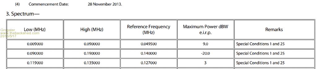

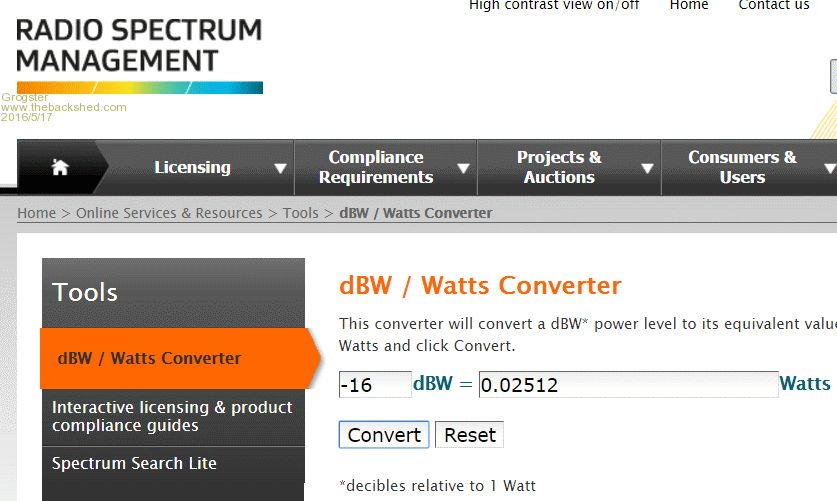

New Zealand allows up to 25mW on 433-434MHz band, sporadic transmission only. Continuous data streaming etc, is NOT permitted. Voice on those frequencies is also not permitted.
These regs are from 2013, but 433MHz band regs don't often change - in NZ at least.
