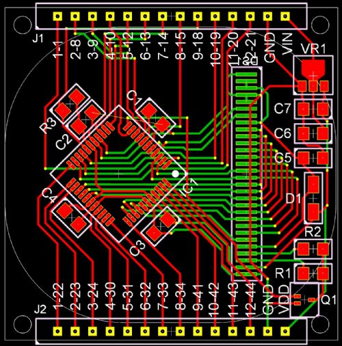

Peter - I am laying out the new stereo PCB using this display and your driver, and your post above mentions that the 64-pin version now uses the defined LCD pins, but the text in the file still says to use specific pins.
...I will be connecting to DB8-DB15 on the LCD, and using MM+ pins 60-64 and 1-3...Edited by Grogster 2016-01-02
Posts: 12183
Posted: 03:06am 01 Jan 2016
  Quote  but the text in the file still says to use specific pins.
Sorry - forgot to update the header text
Use the MM+ 64-pin standard LCD pins for databus and control signals (RS, WR, RESET)
Posts: 10109
Posted: 03:10am 01 Jan 2016
Thanks.
I thought that was probably the case, but before I have to re-do a layout.....

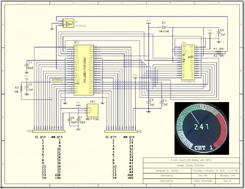

Ok... 4 round displays on order....
I wanted to get the wiring for the PCB correct, so i think it was said to connect the upper data bus bits with the lower ones in case the display you get is the "other" type... So, I would connect DB0 with DB8, DB1 with DB9, ect.. Then put in a solder ball jumper to control pin 26 "IMO" so as to adapt the interface to use the upper or lower data buss... ??
Other questions:...
Pin 2 and 3 (vcc and IOvcc) get connected together ? (3.3v) ?
CS gets tided LOW, RD HIGH, WR tided LOW...
Whats the "MAX" current for the back light LEDs..? should I use a separate resistor for K1 and K2..?
Does the CFunction code able to function with the 28 pin MM V5 core code..?
Thanks for help on this..! Edited by Zonker 2016-01-02

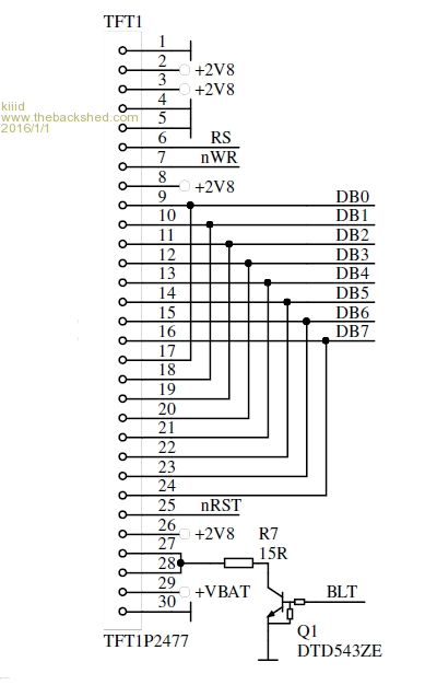

Posted: 07:44am 01 Jan 2016
This is the schematic that should work with both 8-bit and 16-bit displays of this type. IM0 can be permanently high because it is NC in the 8-bit modules anyway.
Note that these displays by specs work with 2.8V supply.
The backlight is better to have two separate resistors, though.Edited by kiiid 2016-01-02

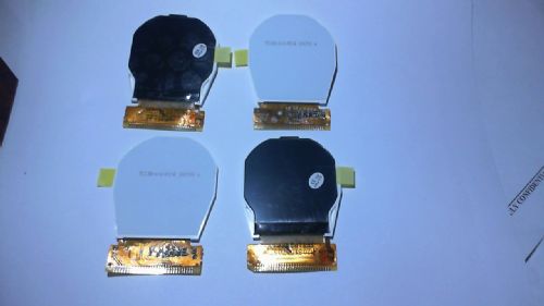

Posted: 06:56pm 15 Jan 2016
Good evening Gents..
Well, the AliExpress order for the round LCD displays came in today.. They seemed in fine condition.. I don't have an FPC connector for them, so I was considering soldering wire wrap wires onto the connector area to get the prototype interface going.. I was wondering if this was a good idea or not, so I thought to ask if anyone else has tried doing this before..? When laying out a PCB, is it OK to just directly solder the display to the PCB, or would using a FPC connector be the way to go..? All the display modules from china seem to directly solder the displays to the PCB's so I guess this can be done... I am currently trying to create a PCB part in Dex for the round LCD... I can't seem to make sense of the PCB pad information in the PDF file but now have the actual display units to check the sizing... If anyone knows the pitch between the pad centers, would be a big help... will be working on it this weekend..
Thanks for any feedback on this...!!

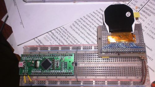

EDIT: I got the Display mounted up and ready for the interface wiring... It took some "Microscope" time to get all the wire wrap wires soldered onto the display..!
Edited by Zonker 2016-01-28

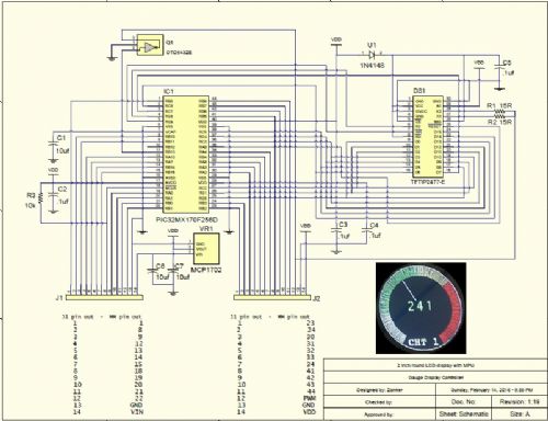

Posts: 12183
Posted: 06:23am 14 Feb 2016
Zonker
Driver for R61505V based display (the round ones) attached configured for 44-pin MX170 as requested. Requires V5.1.
Note this display is tested in 64-pin mode and the similar ILI9325 driver is tested in 44-pin mode but this combination has not been tested although it should work.
Also note (as in the 64-pin version) although the display is effectively 220x220 pixels, MM.HRES and MM.VRES are set to 230 because of the way the display is wired.

Evening Gents...
Just an update on the round LCD Display controller with 44 pinner...
This is the purposed schematic for the PCB... Pin 10 of the MM will be used as an analog input for a yet to be selected light sensor device... Feedback welcome..!!
2016-02-15_035347_Round_Gauge_MPU.pdf
Posts: 2998
Posted: 06:07pm 14 Feb 2016
Hi Zonker,
Just run my eyes over your schematic.
Pin 28 (Vdd) looks like it is not connected to Vdd. This maybe just a labelling issue - but just thought I'd mention it so you can check things.
Nice simple circuit - and would be interested in a photo of the round TFT displaying something.
WW
Zonker
Joined: 18/08/2012
Posts: 772
Posted: 02:57pm 15 Feb 2016
Thanks WW for the good catch on VDD missing..!
Will get it updated... I think I am going to skip the light sensor on this PCB (getting back pin 10), add it to the J1, bump the rest of the IO's around, and drop the PWM drive out, as it's needed to get pin 10 added to the IO's...
Thanks again for the feedback fine Sir..!

Posted: 06:13pm 18 Feb 2016
Evening Gents...
Just a quick update... I haven't got the board dressed yet , or tried any copper pours, ect.. But at least finished the routing...
The red copper is the bottom of the PCB with header pins facing at you, using 1206...
Edited by Zonker 2016-02-20
Posts: 2998
Posted: 06:48pm 18 Feb 2016
Hi Zonker,
Looks good to me.
I notice a 'net' linking C2 to GND in your image, but can see what appears to be a track to ground so not sure why the 'net' is showing itself.
Glad you kept the PWM; and having Pin 10 on the header will allow for an 'external' LDR option to be positioned appropriately.
What are the dimensions of this fine looking PCB?
WW
