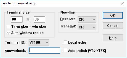

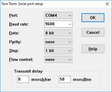

I was trying terminal connection, on Win10 and Linux, and all I can get is the terminal sending just "x" sign to MMX - when I press Q,E,Y,U,i,... on the terminal
my Tera Term VT settings are:
Posts: 2998
Posted: 10:50am 11 Mar 2018
You need to set to 38,400 baud
mallorn
Joined: 14/01/2018
Location: Sweden
Posts: 9
Posted: 10:53am 11 Mar 2018
  WhiteWizzard said   You need to set to 38,400 baud
PERFECT! Thank you!
