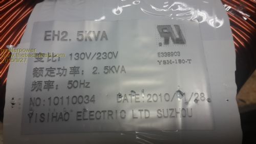

I too believe it could be an earlier or maybe different model as yahoo suggests. Took a pic of the old label as for some comparison if you still have yours. May have binned by now!

Yep looks like there are two possible transformers used by the 2.5kw Inspire's. Either the 240v winding is on the inside, or the outside, of the 130v winding. I got lucky.

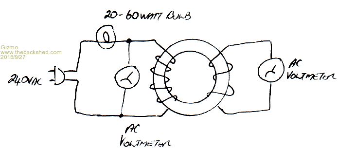

Posted: 01:29pm 27 Sep 2015
Heres a basic test circuit.
Now in this case, because we dont know how many turns are on the primary or secondary, you need to wind a test coil.
Wind say 5 turns of wire ( any old wire ) through the transformer, and connect a multimeter across it. Then connect up the 240v winding like above, with the bulb in series.
Power it up, and take note of the multimeter readings on the test coil, and check the multimeter on the primary is somewhere around 230v, give to take 10 volts..
Say the test coil measured 10 volts, we can work out the ratio's. 10v / 5 turns gives 2 volts ac per turn.

ok. Did some testing.
With light in series on 240 windings ( outer) voltage was 222v and the output on the 130v (inner) windings was 124.
With light in series on 130v winding , (inner) voltage was 134v and the output on the 240 was 237v.
With light in series on 240 winding and 5 turns of cable, output was 7.5v.
Hope this enough info to work things out. Thanks for you help.

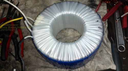

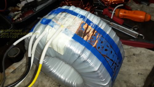

Getting down to the nitty gritty and after removing a layer of blue insulation I uncovered a band of copper that is connected to the earth lead ...always wondered where those earth leads went to? Now I understand if there is a fault in either winding will just go to earth. Duh!

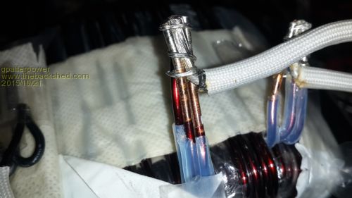

After removing more insulation I uncovered the start and finish of the original primary. It is 3 in hand of 2.25 mm dia wire which equates roughly to 12 sq mm.
Im not sure how many turns there are of this but I was wondering if there is some way I could utilise this or part of this 3 in hand wiring to become my new secondary. Any ideas welcome

So, you have uncovered the 130v winding.... and it is substantial.
Yes you can utilise it if you wish, it is the first 130v of your 240v winding.
From your figures, you are about 1.4v/turn, you need another 110-120v so another 85 turns are needed of two or three in hand... 1.9mm wire.
This will be over the top power wise, but never too much really. 2 in hand will be enough for 3kw.
240/170=1.4v/turn for that core @ 50hz.
For space, if you can peel off one layer of the 130v winding it would not be detrimental for your power, and give you more space to wind the next 85 turns on.
If you were very cheeky, you could split the winding up ( hopefully they are insulated from each other internally). For a 3kw unit I could live with a one in hand 2.25mmm winding. If you were to lose one in hand, and series the other two, you would have 260v secondary, one in hand to use, and more space for your primary.
Primary for 24v would be about 1/16th of your secondary... 260/16=16v .... so 16/1.4= 11 or 12 turns of welding cable.... 50mmsq or more.
If your not going to run this hard for extended periods, this should be sufficient, and save a heap of work..... or strip it all off, and start again with 170 to 180 turns of two in hand for the secondary.. epoxy as you go, and it will be silent as well as virtually indestructible.

The copper layer is a shield... less RFI in sensitive equipment, not a safety concern.

So there's a couple of way I can do this. The quick way out would be like you say to separate the 3 in hand , series 2 together and disregard the third. I'm assuming that would give me a 3 kw with not much room to spare....... If some one has the toaster on and the fridge cuts in at the same time someone else is boiling the jug for a cuppa....then the inverter IS TOAST. I would like to run the house if that's feasible so Im thinking of just continuing on with another 85 turns of 3 in hand of 1.9. Is that overkill or is 2 in hand enough to do the job and what sort of output could I expect?
Could another way be with the 3 in hand , separate one and wind another say 110 turns in parallel with the single with 2.25 and then series with the other 2 in hand winding. The only drawback is that im only guessing with amount of turns there are and may cause some imbalance and overheating when in a full load scenario. Just a thought!
