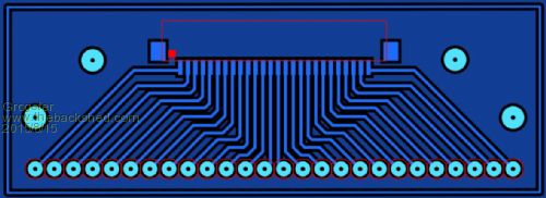

UPDATE: I have removed the FPC(flexible Printed Circuit) socket from the circuit board using Chip-Quik, and have used it to find some new replacements. You can buy 10 of these connectors for US$5 with free freight from eBay.
FPC connector to suit blue keyboard matrix
I also designed an extremely simple breakout PCB for this connector, so that I can experiment with the matrix decoding. This PCB I will etch here at home tomorrow, as it is so small and simple, and then I can get to experimenting with the matrix right away.
At this stage, I am going to try the "Rob method"(robert.rozee) to decode the matrix - a small plug-pack, and an LED + resistor. I will translate the keypresses from the matrix, into a spreadsheet for future reference, and also for including in the constructors pack.

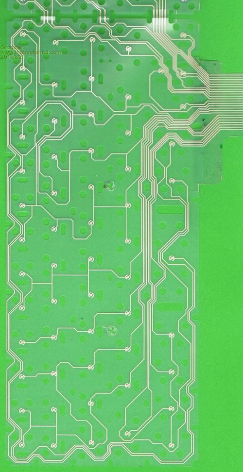

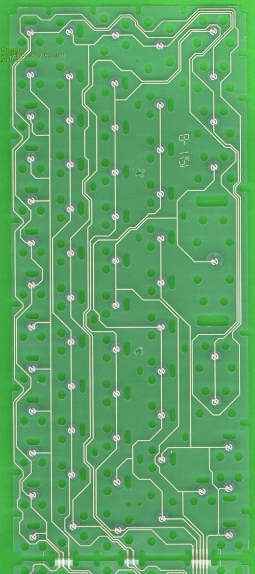

Here are some shots:
From what I can see, it would appear to be a 8 x 16 matrix, with the eight on the top layer, and the 16 on the bottom.
The hand-written chart above lists the keycode connections in the CODE column, in a BOTTOM LAYER,TOP LAYER format. Therefore, the ENTER key is CODE 12,20 - meaning lines 12 and 20 will give a closure if ENTER is pressed. There is a normal resistance on this matrix ranging from about 50R through to about 350R for the longest traces.
EDIT: The chart is missing one data point for the ':' key - it should read 12,18.
Pin '1' is the trace closest to the writing on the FPC cable: 'HASKEY.....' etc.
