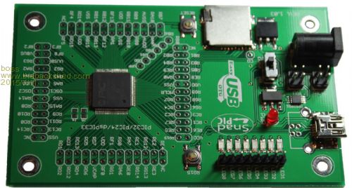

Posted: 07:57am 11 Jul 2015
Hi everyone,
I found this PIC32MX470L (100pin) board on eBay.
It maybe good starting platform when the 100pin FW will be available
http://www.ebay.com/itm/Microchip-PIC32-PIC24-dsPIC33-USB-OTG-Development-Board-Starter-kit-SD-Card-/181197009902?pt=LH_ DefaultDomain_0&var=&hash=item2a302ef3ee

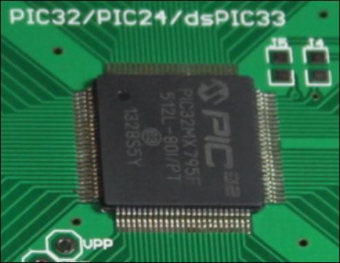

Posted: 08:21am 11 Jul 2015
Bo
Although they are very careful not to say, that board looks like it is a PC32MX795F512L. That was used in the Maximite several years back.

Posted: 09:55am 11 Jul 2015
Hi Bo, BobD
I have one of the SNADPic PIC32MX470F512L modules here, but it's unfortunately not usable with the MM+ s/w because the SNADPic board uses a 8MHz xtal, and the MM+ s/w requires a 20MHz xtal.
Before someone asks why 20MHz vs 8MHz, I asked Geoff and he explained
  Geoff Graham said  20MHz was necessary to get a clock of 120MHz.
The PIC32 firstly divides the crystal to get the frequency between 4 and 5MHz. For an 8MHz crystal this would require dividing by 2 for 4MHz, where with a 20MHz crystal dividing by 4 gives 5MHz. Then the PLL multiplies this frequency. The highest multiplier is 24 so with an 8MHz crystal we end up with a clock of 96MHz but with a 20MHz crystal we end up with 120MHz.
Otherwise the SNADPic module is a very nice unit, well made, and very reasonably priced, USD 30.99 / GBP 19.98 here in UK, and it ships from inside the EU so no additional taxes/duties for EU countries.

Posted: 12:51pm 11 Jul 2015
@BobD
They have 4 CPU to choose from including 32MX470L. Check on eBay. The board is the same, just the chip is different.

Posts: 268
Posted: 01:01pm 11 Jul 2015
@Peter
The seller is a Czech fellow and I believe you can kindly ask him to remove RTC 32kHz crystal and related capacitors and replace 8MHz crystal with 20MHz as well. The board price is around ~30 bucks and the shipping ~ $3.

Posted: 01:47pm 11 Jul 2015
Hi Bo
I thought of that, and indeed he is a most obliging fellow, so maybe I will consider returning the board to him with a request to replace the 8MHz with 20MHz XTAL.

Posted: 04:50pm 11 Jul 2015
  boss said   @BobD
Bo
Bo
Thanks, I missed that. Too early in the morning. I should have gone to sleep instead of replying to your post at 4:00am.
It does look like a useful board.

Posts: 268
Posted: 07:57pm 11 Jul 2015
Hi everyone and greeting from Vancouver ,
I had some chat with the seller because there is necessary to do some changes on the board:
1) Replace 8MHz crystal with 20Mhz Xtal
2) Remove 32kHz crystal and associated capacitors
The seller agreed do this mod for not extra charge, there is his post:
The seller is located in the Czech republic, so I wrote the mod request in Czech. But seller prefers communication in English
Dear kovois,
Hi
Let's speak English:)
Yes, it is possible.
You want a SnadPIC board MX470 which has 20Mhz crystal, and remove the 32khz and its capacitors, so RC13 and RC14 will be available,
But the board will be RED .(not green)
OK,you can buy the green 470 device and we will make the changes you want.
Just leave a note (message) : just write : NEED CHANGES to let us remember.
best regards

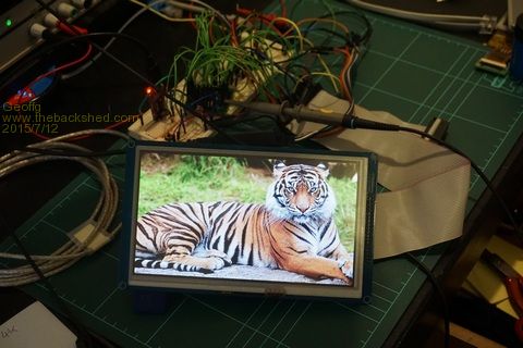

Posted: 12:40am 12 Jul 2015
Thanks Jim (viscomjim).
Thanks Boss for the post on the SNADPic PIC32MX470F512L module. I have just ordered one of them with the mods negotiated by you. It looks like a great board and I will be using it to develop and test the 100-pin version of the MM+. Much easier than my current test setup (in the top part of the photo below).
