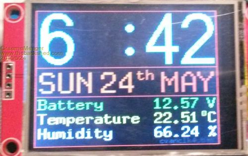

Here is the code I am using and I am trying to shift the single digit hour across one space or specified character before the digit.
If Val(Left$(Time$,2)) < 12 Then
Text 5,1,Left$(Time$,2),LT,2,2,RGB(Cyan),RGB(Black)
Else
Hrs=Val(Left$(Time$,2))-12
Text 5,1,Str$(Hrs,2,0,"-"),LT,2,2,RGB(Cyan),RGB(Black)
EndIf

It should work Graeme.
I will have a look at it ASAP (I have a lot of things on at the moment).

Hi Graeme and Geoff,
I've just tried it and there does seem to be a problem with the STR$ function. STR$(hrs,2) only returns one character if its <10 hrs.
When I was using it with the Micromite 1, V4.5 and with the LCD command it was working correctly.
The following is a workaround:
hours = VAL(LEFT$(TIME$,2))
IF hours < 12 THEN
IF hours <10 THEN
Text 5,1,"0"+STR$(hours)+":",LT,2,2,RGB(Cyan),RGB(Black)
ELSE
Text 5,1,STR$(hours)+":",LT,2,2,RGB(Cyan),RGB(Black)
ENDIF
ELSE
hours = hours-12
IF hours <10 THEN
ELSE
ENDIF
ENDIF
You can replace "0" with " " of course if wanted.
GregEdited by paceman 2015-05-25

The answer has just dawned on me!!!!!
Font 2 does not have a space or a minus (-) character. So, when you specified either of these as the leading character MMBasic just skipped it as a non printable character.
If you had tried:
Text 5,1,Str$(Hrs,2,0,":"),LT,2,2,RGB(Cyan),RGB(Black)
it would have done what you expected because the colon (:) is in the character set.
It seems to me that the space and the minus (-) characters are more important in a numeric character set than the colon so that is something that needs to be changed.

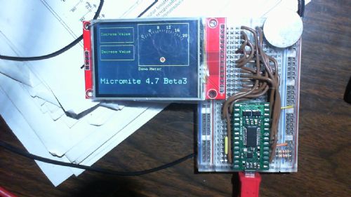

I finally got a chance to play with the new firmware... Nice..!
I went back to the TFT MM demo programs and converted a meter object to the 2.4 inch touch panel to play around with... Still working on it...

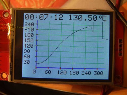

  Geoffg said   There has been a lot of comment on the loss of the SPI channel to the display/touch controller.
hmm, seems the MM lost his SPI ability? (if you don't disable the LCDPANEL)
... I wanted to use the new LCD capability with a SPI thermocouple circuit (MAX31855). I got it already working with Peters Graphic library.
A display for my Reflow-(Pizza)-oven (3x SPI: LCD, Touch and MAX31855 thermocouple amplifier).

OPTION LCDPANEL ILI9341,L,4,5,6
OPTION TOUCH 7,2
