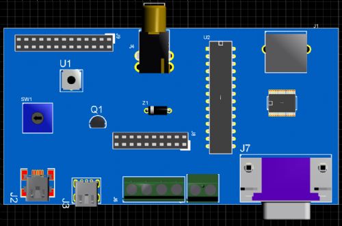

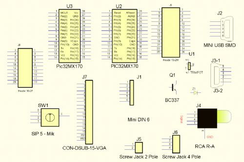

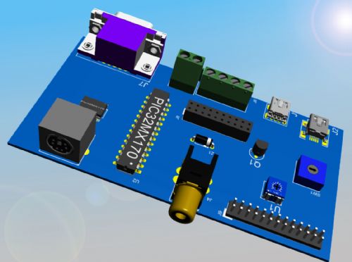

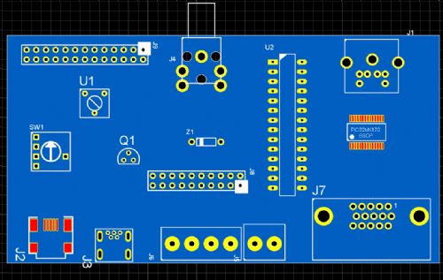

Hi Lads,
A few more additions to the Mik_libs
I have been trying to implement 3D in all parts so bare with me..
As you can see there are a few minor issues (MINI USB Through hole Schematic for one)
But it is still a work in progress. I have added a lot more headers and extended the range to 2 row headers as well.
2015-02-22_041232_Transistors.zip
2015-02-22_041249_ICs.zip
2015-02-22_041309_Headers.zip
2015-02-22_041622_Connectors.zip
2015-02-22_041645_RCA_.zip
2015-02-22_041703_VGA.zip
Note Due to the 3D models size the RCA and VGA headers are in their own ZIPs
Here are some screen shots:
PS. If anyone has any comments that can improve the libraries please let me know or if you have any parts that you want a lib part for also let me know.

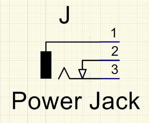

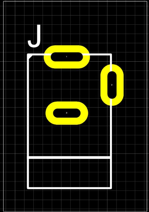

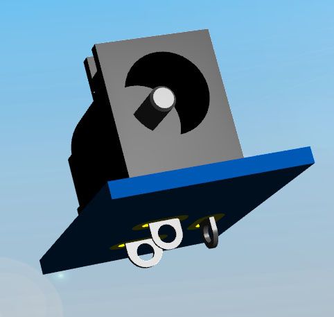

Hi All,
One of our members asked me for a standard power jack connector as he couldnt find one in the included DEX libraries..
I found some (not named as you would expect) but they were pretty ordinary and had tiny holes and small pads and of course NO 3D image.
So I created this part for him.. I have uploaded it here as I am sure others might want it too.
2015-04-02_234533_Power_Jack.zip

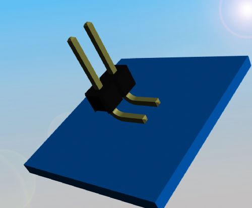

Posts: 2984
Posted: 04:17am 14 Jul 2015
Hi Willy,
On my free XGL viewer that looks to me like a SMT right angle 2 pin 0.1" header.
When I import it into DEX it somehow looks like a one pin instead..
If that is correct try this one
2015-07-14_141532_2Pin.zip
It looks like this once imported into DEX
FYI. I got the part from 3D content as a solidworks 2014 model and used autodesk inventor to convert it to XGL format
