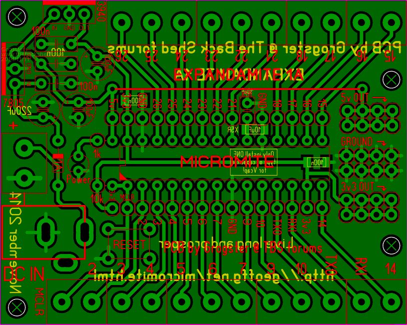

OK, try this one on for size:
I have allowed for either SMD or leaded MLC cap for Vcap. Extra headers added.
Can we squeeze anything else in?
@ centrex: I will be posting the gerbers once everyone is happy. I will also be getting some made, so members can get them from me if they want one, but don't want to bother etching their own one. Any board(s) I supply, would have a SMD 10uF MLC ceramic fitted for Vcap.
EDIT: Swapped two leaded 100n's for SMD versions. It's neater, and not so "Tight". Any boards I supply will have the three SMD parts fitted for you, so all you have to do, is all the other thru-hole parts.Edited by Grogster 2014-11-12

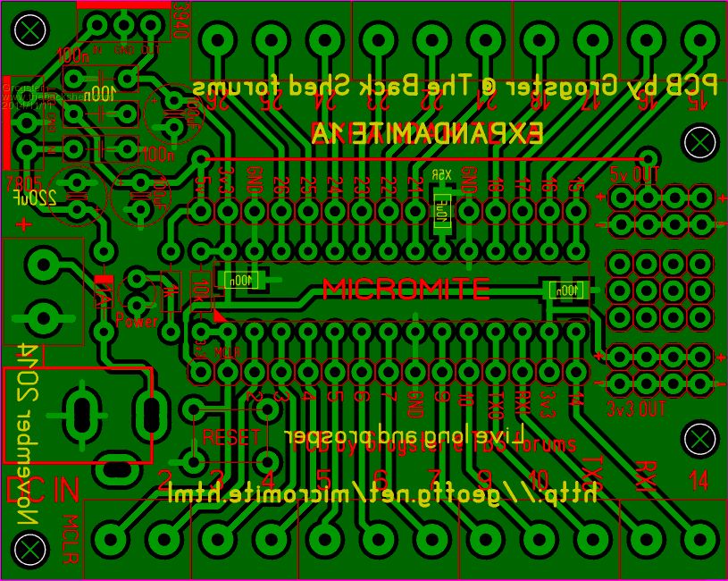

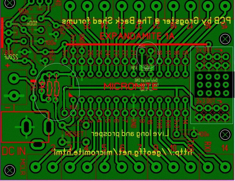

A few more suggestions. I hope you see the value in it, because it comes down to personal preferences and yours are probably different then mine. So ignore if its not valuable for you. :)
I would change the resistors placement slightly so that they can be mounted flat.
Having the resistors stand up right next to the connector will interfere with something you plug in.
This is also the case for the cap on pin 19/20.
Furthermore having a small 'sea of holes' can be very handy for those small addons that always seems to happen.
Smaller power strips for 5v and 3.3v both with their own ground strip.
I made a crude paint version of your pcb with the modifications encircled with blue.
Edited by TZAdvantage 2014-11-12

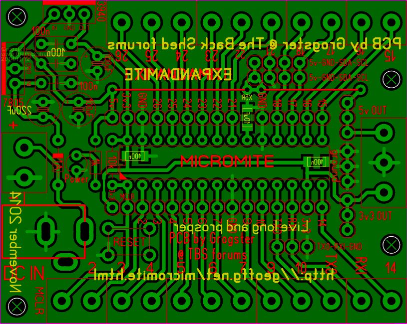

Posted: 12:14am 11 Nov 2014
Nice thinking - will make the changes.
Stay tuned....
EDIT: OK, how about this?

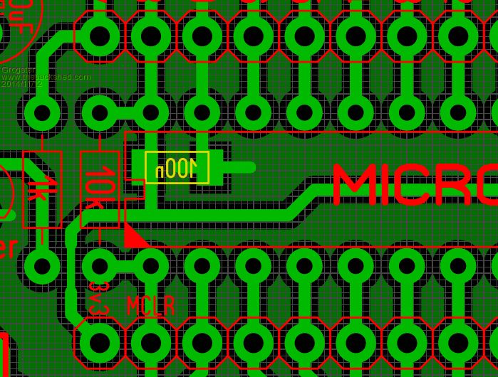

The PIC32 and headers are all standard 0.1"/2.54mm pin spacing, but the underlying grid is 0.3175mm, in order to squeeze everything in, and still allow for neat track layout.
So, if you use a 2.5 grid, you WILL NOT be able to design a daughter-board to fit.
However, if you use a 0.3175 grid, you will have no problems at all with spacing.
All PCB layout software allows you to change the grid size, and most of them let you change it on the fly. Standard practise is to stick to one grid size, but in this case, I have changed grid sizes depending on what I needed to factor in.
However, the PIC32 chip, and the header strips either side, are on a common grid - that being 0.3175mm. Example:

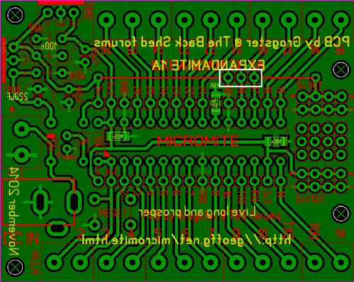

As for the PCF8563 (which IMHO is turning your board into something you didnt intend it for and Single sided is a bit much to expect), However
A simple addition of 3 pads (with no other track modification) as shown in the white box here:
Would enable a PCF8563 plug in module similar to This One
To simply plug in (skipping the Vcc line which should be unnecessary due to the battery)
PS. It also allows a connection to other I2C devices if the module isnt needed.
MikEdited by bigmik 2014-11-13

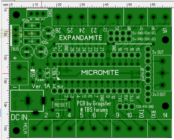

Posts: 10108
Posted: 01:57am 12 Nov 2014

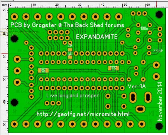

Okey dokey people.
This should just about do it:
Added 2x 4-way headers for I2C - should be pin-compatible with those 8563 RTC modules that Mick linked me to. All things being equal, you can just plug it directly into the board, and you are ready to rock 'n' roll. That module is kinda long and skinny though, so it would probably be a better idea to solder it in for mechanical stability.
Also added a 3-way header for the console.
Whaddya think, guys - done board?
EDIT: Some mock photoviews of the PCB.
Top:(silkscreen)
Bottom:(copper layer)
Edited by Grogster 2014-11-13
Posts: 2984
Posted: 02:55am 12 Nov 2014
That is looking really good Grogster,
The 5v on the I2C is a good addition as well.
Posted: 03:37am 12 Nov 2014
Yeah. I like it!!
Just a consideration for you to make about the parts used.
You have the 100n capacitors in through hole and smd versions.
Would it not be better to make all of them smd.
It will make the BOM smaller and fewer types of parts are needed.
Making it easier for someone to source the parts and a little cheaper as more of a single part can be used.
I would change the silkscreen for the t-blocks slightly.
On the bottom (pins 1-14) I would use four 3-way blocks and on the top five 2-way blocks.
Is the 1k resistor on the mclr enough to the left to allow a dip socket?
The power LED is now on the 5v. This will indicate that 5v is available but not if 3.3v is available. You could add another led, or change the connection of the led to the 3.3v. This would then indicate that 5v and 3.3v is available.
And just for kicks. :) Add another pin for 3.3v to the console connector and make sure the order of the pins is right so that Geoffs vt100 terminal ( http://geoffg.net/terminal.html ) can be connected and powered directly from your board.
:) Already getting tired from me? :)
Edited by TZAdvantage 2014-11-13
