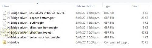

I am not Mick, but this is all I did - export the Gerbers and drilling data to a folder somewhere, then zip all the files into one ZIP file, and send them that along with your order-number.
These filenames were generated by my PCB software(Sprint Layout 6), but I did add the EXCELLON DRILL DATA to that file, for clarification.
I zipped all the files into a single ZIP file using 7-Zip(store, no compression), and then emailed that ZIP file to them.
