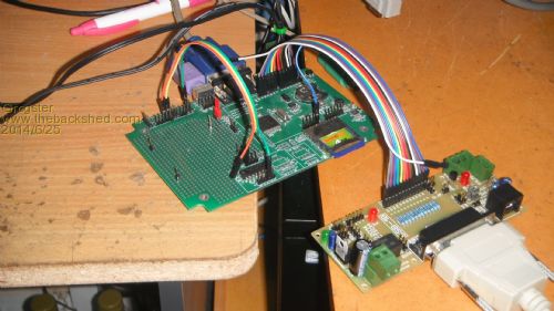

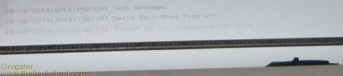

Here are a couple of photos.
The third line on the printer says: "Thanks to CircuitGizmos for this idea" - the printer ribbon on this printer is getting a little dry.....
EDIT: No matter what size I make this photo, the forums are re-sizing it, so you probably can't read the other two lines either, which say: "Test message." and "Hello Back-Shed people!!!"
