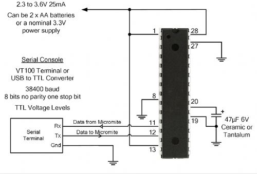

  viscomjim said  How many beta testers for micromite and how many users of maximite have ever considered this as an issue. I have not seen any forum posts that read, "I can't get my terminal program to talk to xmite as I can't seem to figure out the meaning of RX an TX."
Hi viscomjim,
This is probably because Geoff supplied a circuit that it completely clear and unambiguous.
See the following Circuit from the manual. Not only did Geoff draw little arrows to show direction, he added text to emphasise it.

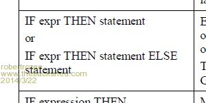

Posted: 04:12am 22 Mar 2014
aha! i had just copied the syntax from page 37 as it was formatted:
rob :-)
