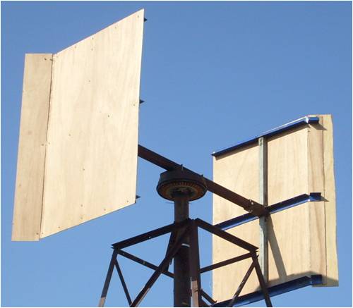

finally got time to wack together a miller. It has 80cm wide 3ply panels [excluding the starting lip] and 120 cm high.
the starting lip is 16cm.
The space between is 150cm. It is mounted on my neo f&p brake drum conversion I did some time ago. here.
http://www.thebackshed.com/windmill/forum1/forum_posts.asp?T ID=899&KW=clarence&PN=0&TPN=5
Today the wind is westerly about 15-25 kmph but very turbulant because of my house. It starts with gusts [no load] and spins for a while but is very hard to evaluate at this time because of the turbulance.
It is probably a bit heavy too. each panel weighs about 10kgs. Also I think the panels might be spaced too far apart. Perhaps 120 cm would have been better?
Overall I am quite happy with the construction, and it should be strong enough to withstand big winds I hope.

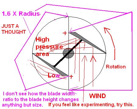

clarence,
When I look at the picture you have posted I see a pair of- in-congruent blades or optical illusions, It appears that one of your J-hooks is trailing and one is leading ?
EDIT: The illusion is resolved, blades are fine.
I'm Going to paste a thought here for you guys to mull over.
MacGyver, TYMF, Any remarks here? Yea-Nay??

Hey, good for you! My hat's off to anything that works. I've been on a downward spiral lately; everything I build just sits motionless.
Once all the bugs are out of your Miller rotor, maybe you could post a picture and some final dimensions for we dummies (speaking of self mostly!) out here to merely copy.
I still don't see how this thing works even on paper. My son is an aeronautical engineer and he could probably tell me, but won't take the time to even look. He's of the opinion I'm wasting my time on anyything I do out in my shop.

Greenbelt
I have tried setting the vanes back as you have in your diagram but it didn't do as well as with them even, I also tried them forward which was worse
I also don't see how the chord v span effects it either but it does
There has to be something else going on apart from drag downwind and lift upwind, a central vortex perhaps
I don't know and thats why it intrigues me so

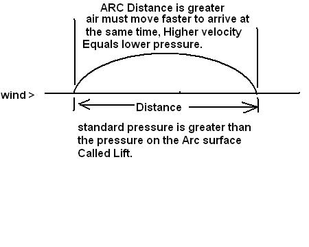

MacGyver;
Lift and normal air;
Wind blowing against a flat board is normal air, DRAG. air moving over a rounded form in a smooth angular transition (curve)will normally speed up, Higher velocity causes the pressure to drop, when this happens the pressure on the Flat side of the rounded form will be higher tending to move the object toward the lower pressure. LIFT.
This is a very basic Drawing to illustrate the principle,and you will not likely find an airfoil like this.

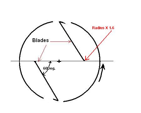

ALL YOU MILLER GUYS;
The Drawing I posted on Page 4 Has Several Flaws, one of which is the direction of travel, next the J-hooks are on the wrong end of the blade.
I set up a fan in the shed today and cobbled a couple blades from 1/4" plywood and a 2 foot by 6" by 3/4" board.
I mounted the blades as shown on page 4 turned on the air Fan and it--- ran backward? There you have It, Murphy lives at my house.
I mounted the blades on my cross board using a single screw to hold them on. I could change the angle of attack and then determine the best torque angle for the blades.
When taken from the diameter line at the perimeter my best angle was 60 Deg.If I decide to finish this I will opt for a 4 blade design because 120 deg of this circle has no torque. (60 deg. 2 places)
