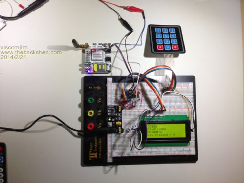

viscomjim
Joined: 08/01/2014
Posts: 925
Posted: 04:33pm 20 Feb 2014
MicroMite Cell phone...
Works great - can make and receive voice calls using headset, best part is playing with SMS to control things...
So far I can tell you the keyboard routine works great, the LCD works great using 2004A, serial works.
This thing is great!
Thanks Geoff

viscomjim
Joined: 08/01/2014
Posts: 925
Posted: 01:23am 21 Feb 2014
Hi Grogster,
The GPRS/GSM module is called Efcom pro. The manufacturer is Elecfreaks.com It also comes as a shield (for maximite use). I paid $45.00 for it on ebay new. It uses the SIM900 module and simple AT commands like a hayes modem did back in the day. It will need a sim card to operate. I got a month to month cell plan with talk and SMS only, no data to keep it cheap ($5.00 month), however the unit can do data also if you want web connectivity. Using caller ID, you can do a simple operation (like open a gate) and never answer the phone, or use SMS and do whatever your heart desires. Make sure to use COM1 as it is 5v tolerant. I powered mine off a 5v 2A separate wall wart to play with as the data sheet says it can have up to 2 amp spikes once in a while. I guess larger cap could help with a smaller supply.
