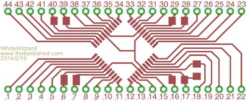

Grogster,
Now its not so pretty!
Heres the mod:

Eagle files to make Eval PCB/Module
I keep getting a 'Bill Gates' error when generating the Gerber Files so to avoid any more delay I have attached the actual Eagle files:
2014-02-11_010903_MicroMite_v3.brd.zip
Component values are included within the file but please feel free to contact me if you need any help!
For anyone just wanting a single sided PCB comprising of simply a 44 pin DIP (i.e. no USB or ICSP circuit) then here it is re-posted:
2014-02-11_011112_MicroMiteDIPv3.brd.zip
For those of you that don't have the Eagle software, download a light version for free from the following link:
Free EAGLE download
Please let me know if a circuit diagram is required! I don't currently have an electronic copy so it will take a couple of hours to produce . . . .

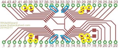

Posted: 04:38pm 10 Feb 2014
Nice compact boards.
I would suggest looking at the traces i circled in yellow.
Those traces connect with a very sharp corner to the pads.
Most PCB houses suggest to prevent this as it can cause 'peelables'.
Page 11 point 10: eurocircuit pcb design rules.
Their automated system will reject those traces.
The traces marked with blue could be straight. Allowing the traces next to it to be a little longer before they go into a 45 degree corner.
Personally i would make the traces the same width as the 44pin pads,but only when it is manufactured with a soldermask.

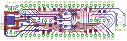

I have finally made all the required changes to the 44-pin Eval PCB and am about to place an order with iTeadStudio.
However, it is very late here, I have been in front of the screen for many hours now, and I really could do with some extra sets of eyes to have a look over what I have done.
Hence can I please ask all you wonderful people with Gerber Viewers to run your eyes over the attached files to spot any obvious mistakes!
2014-02-18_041737_MicroMite_v1.zip
I have built several prototypes so I know the circuit design is robust - I am more concerned with the files themselves (i.e. missing files, incorrect format, spelling, etc)
Many, many thanks in advance for your help . . . .

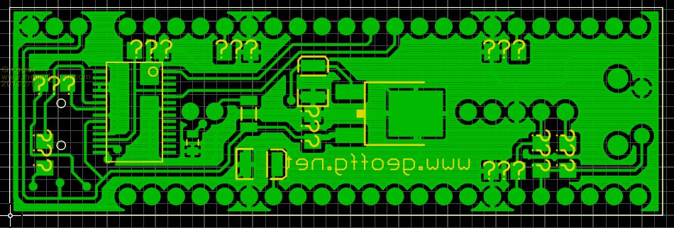

Posts: 10105
Posted: 06:58pm 17 Feb 2014
Very sexy indeed.
Imported fine into Sprint Layout 6, but no drill-data.
I think that is about the only missing file - everything else seems to be there.
EDIT: Some silkscreen missing from some of the copper2(bottom layer, GBO file)?
Some pads don't have any indication caps etc are supposed to be there?
See image below - I have put ??? beside pads I thought were supposed to have some kind of silkscreen ID...
