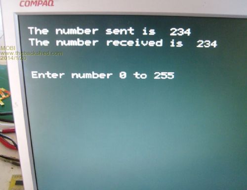

Posted: 06:39pm 19 Jan 2014
Hi Jman
Thanks for the inspiration. I think all my problems were noise related.I've swept the floor and collected all the hair. Now who is that hair transplant mob?
I commented out the weak pullups as they shouldn't be needed as port b is output with resistor and led external pull ups and port a is tied to logic levels from port b.
IOCON only needs initial set up at &H0a as the registers concerned are shared.
The numbers on the 7seg display are just 1 2 4 8 and nothing to do with the expander, just an indicator that the i2c bus was working so I left it in.
The expander is in that block of connectors in the foreground.
Mode 4
Cls
4 x7segdisp = &h38 'i2c device address (LED)
expander = &H20 'i2c address expander
Dim inpina 'data read from 8bit wide port a
Dim inpinb 'in case needed
dim number 'value 0 to 255 entered at keyboard
'Bank 1 mode
iodira = 0
iodirb = &H10
iocon = &H0a
'ioconb = &H0b
gppua = &H06
gppub = &h16
gpioa = &H09
gpiob = &H19
olata = &H0a
olatb = &H1a
I2CEN 100,100 'enable the i2c bus
I2CSEND expander,0,2,iocon,&Ha0 'set config bank 1
I2CSEND expander,0,2,iodira,&Hff 'port a inputs
I2CSEND expander,0,2,iodirb,&H00 'port b outputs
'I2CSEND expander,0,2,gppua,255 'port a pullups
'I2CSEND expander,0,2,gppub,255 'port b pullups
I2CSEND expander,0,2,gpiob,&Hff 'clear port b output
I2CSEND disp,1,5,0,1,2,4,8
start:
Input "Enter number 0 to 255 ",number
Cls
I2CSEND expander,0,2,gpiob,number
I2CRCV expander,0,1,inpina,1,gpioa
Print "The number sent is " number 'send byte to port b
Print "The number received is " inpina 'receive echo byte from port a
GoTo start
David M.

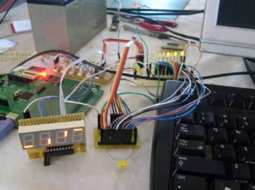

MOBI
Joined: 02/12/2012
Posts: 819
Posted: 09:30pm 19 Jan 2014
The expander also works in bank 0 mode just by substituting the corresponding bank0 register addresses.
Moral of the story, NEVER leave pins floating. I got lazy and tried to use just the one pull up resistor and LED on the expander port pins one at a time. I guess in the past I just got lucky.
The same thing applies to decoupling capacitors ALWAYS fit one to the vdd vss pins. I have been caught with that one even though mostly I've got away with it.
The long and the short of it - all works on the expander just as it looked like it should have. Just call me baldy now.
David M.

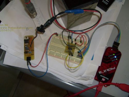

Posted: 08:18pm 20 Jan 2014
@TZA
Now that has put the data expander to bed, we can start on turning the PIC16F1503 into an I2C slave and see if we can get it to act as an I2C LCD display.
I cleaned up (syntax wise) a F88 programme I had and successfully dumped it via MPLABX IDE to the 1503. Of course, it doesn't do anything yet. First I'll flash a led to let me know it is working and then I'll fix up the I2C slave mode and flash another led. Different registers, different location and names. Let you know how I go along the way.
Picture is a bit fuzzy but that's hardly surprising.
David M.
MOBI
Joined: 02/12/2012
Posts: 819
Posted: 09:54pm 20 Jan 2014
Pic Slave.
Ok, so I didn't flash a LED but a square wave on the cro is as good as a nod to a blind horse. The internal clock tripped me up a bit, needing a register and config words both set up right. Now for the I2C bit.
David M.
