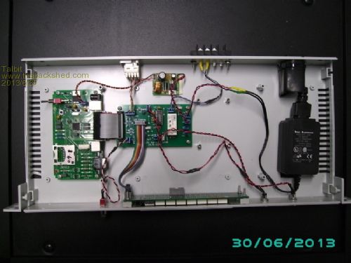

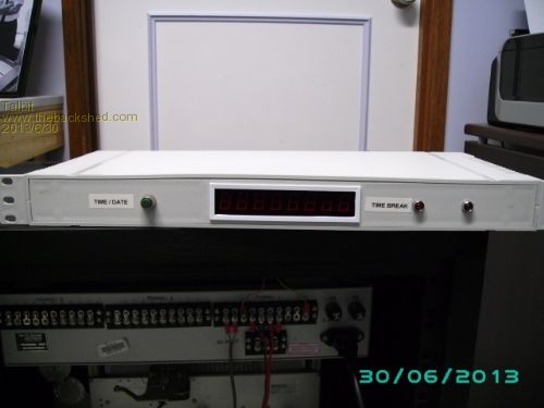

Here's some photos...
Let me know if you want more.
