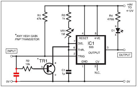

I built the 555 missing pulse detector linked to by centrex, and although it works very well indeed, I have found one really major issue with it, so I want to run it past the rest of you for ideas.
The problem with this circuit, is that on initial power-up, the 555 output is low, meaning that if connected to the MM, at power up, the 555 circuit will hold the MM
Hi Groggy,
I had a look at the CCT in question and I think that if you add one capacitor to the mix you may be able to trigger the timer on power up and keep the output high for 1 time cycle.
See the cct below.. I am not sure what value but you could experiment starting with 1uf and go up and down as required..

And on the 555 circuit, I will try that, and let you all know - thanks for the hint.
I have pulled the circuit to bits now, but I can rebuild it on the breadboard in a few minutes...

  Grogster said  And on the 555 circuit, I will try that, and let you all know - thanks for the hint.
No worries, Maybe the cap might work better on the other side of R2, trial and error here.. It would probably lengthen the strobe pulse so bear that in mind...

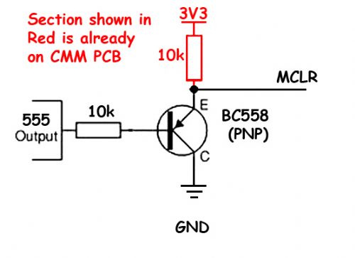

I guess we still have an issue in that the 555 circuit needs at least 4.5v to operate, and I am pretty sure that the PIC32 reset pin is NOT 5v tolerant, and more then 3v3 on it's reset pin will probably kill the PIC32, so the 6369 chip might well be the best option, albeit with it's tiny pin spacing, as you can run it right down to 2.5v.
Of course you could route through a transistor switch, I can provide a cct for that if you need it, that switches between 0V and 3.V.

Not sure the series diodes would work, as while they would drop the voltage to the reset line, they will block the 555's attempt to pull the reset line low, would they not, as they would be reverse biased?
I would be running the 555 circuit from 5v.
I am guessing that your transistor idea would be the best option.
PNP type, emitter to PIC32 reset, collector to deck(ground), 1k base-loading resistor to 555 output. That way, when 555 output is high, PNP would be off, allowing PIC32 to run. When 555 output goes low, PNP will pull reset line low via C-E path, resetting the PIC32.

Here is a possible cct for the output of the 555

I will build the standard 555 circuit again, and see what happens with the extra cap suggested by Mick, just using LED's as the original circuit shows, and not connected to the PIC32 yet.

Kudos to Mick - he was really on to something with that cap.
I added a 1uF and now the 555 output is high on power-up for the first time cycle.
I actually lowered the value of the cap down to 100n, and it still works great.
I think I will still use 1uF on the final design though, unless someone else here can suggest why that would not be a good idea. Perhaps 470n? - somewhere in the middle...
I will now swap the 555 for a 7555 - but I have to drive to town to get a couple of these, as I only have the standard 555's here.
Once I have them, I will plop the 7555 in there, and then start playing with 3v3 and cap values etc. I plan to use a tantalum in the final version, for the timing capacitor, to keep the time period reasonable stable over time.(if you'll pardon the pun there...)
PROGRESS!!!! Edited by Grogster 2013-06-13

If I remove the LED on the 555 output(and it's resistor), and move these to the discharge pin(LED's load resistor still to 5v, LED cathode to the discharge pin), then the LED still comes on after the time-out period - perfect.
I have settled on a 470n cap on the input transistor a-la Mick's idea.
I removed the link between discharge and threshold - the rest of the circuit is still the same.

  Grogster said   Kudos to Mick - he was really on to something with that cap.
PROGRESS!!!!
A pleasure mate... Did you move the cap to the Transistor side? (I think it would be better there)... And I just took a guess at a suitable start value... On your observations I would probably go with 220-470nf...
