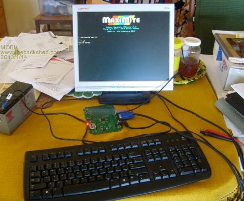

Posted: 03:43pm 13 Jan 2013
I'm on my way from misery to happiness today....ay ay ay ay.
I've plugged in both colour maxis, selected Vin and voilla they work.
Now for some serious fun.
Ok, I haven't cleared the bench yet - the kitchen table will do for now (I'm still batching)

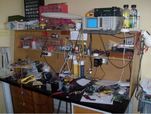

  MOBI said
You should start a "this is my work space" thread with this picture. I think it would be fun to see other people's work spaces.
