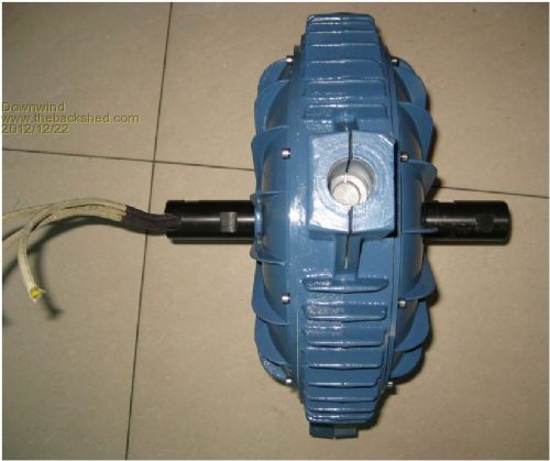

Seen you like the details on OEM website to quote all your information from, then you would have surely noticed their listed 2kw mill has a blade diameter of 5.5m and their 1kw mill has a blade diameter of 4.0m.
The listed 500 watt mill has a blade diameter of 2.6m
Now you have a blade diameter of 2.6m for your mills, dont that tell you something about the mills you have.
Posted: 06:35pm 21 Dec 2012
Due to the fact we really dont know what mills you actually have, it is not very practical to make recommendations to equipment needs or design advice.
Can you take some clear photos of the mills and equipment you have and post them to the forum, as this might give a better indication to understand the actual products you have.

Do you start to see the bigger picture, if there is a small change in turbine design, then it may not be what you think you have as a mill.
Or which version or which model or what ever.
Do all the mills have the same 2Kw marked om them, and are they 100% the same in every way as far as you can tell by inspecting at them.
From the cost you have outlaid to date and looking at the return factor i struggle to see this installation ever break even, with solar and wind combined.
As you say no turning back now, and you are only able to make the best of a bad situation.
Posted: 11:57pm 21 Dec 2012
  Quote  think its a bit different there is a piece of pipe coming from the rotor where u attach to the tower with a few bolts as inn u tube video
I will bet you a half eaten christmas pudding its a 500 watt mill, if that is the case. (one of the versions that may produce 2kw in a cyclone if it didnt self destruct before hand)
First indication, do it have the cooling fins on the rotor casting? (like in the photo i posted)
If it do, then the measurements of the rotor, including axle dia.
Just to warn you, it might be a case of you think you have a total of 6-9Kw mills and only have a total of 1.5 Kw mills.
Until we know, its just pissing away your cash, for example if you build a tower for 2-3kw mill and only fly a 500w mill then its a huge overkill in cost, same for inverter and batteries, wiring, controllers, etc.
Workout what hardware you have and the rest will fall into place.

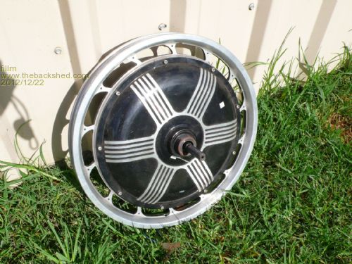

Im thinking it will be the later version with the bigger generator motor than the 500W but exactly the same type of down wind design as the very first , with welded blade mount spigots , the black bike wheel end plates as in the pic will give it away and the stupid looking tail out the back.
Heres a pic of the parent 1000w wheel motor that they turned into a 2000W generator.
Hopefully you can work out how to upload photos to help this along.
