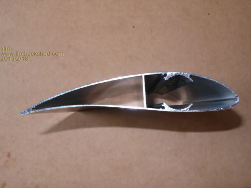

Here's a pic of the Alu profile and from what I can see you are dam close , if you want an off-cut to assist , then I am more than happy to send you one to use as a template etc, drop me an email through the Blade order section if you want .
Keep up the good work..

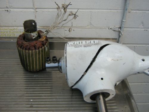

I run a up wind mill using a modified narcel from a Whisper mill that hit the deck and trashed the alternator. (the narcel survived)

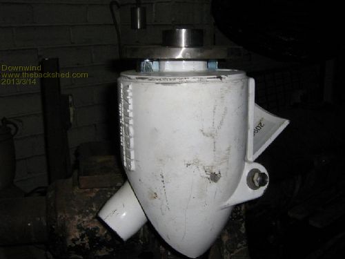

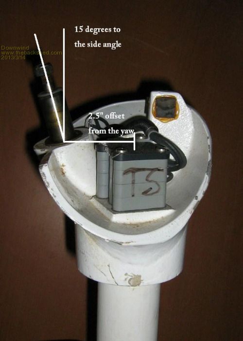

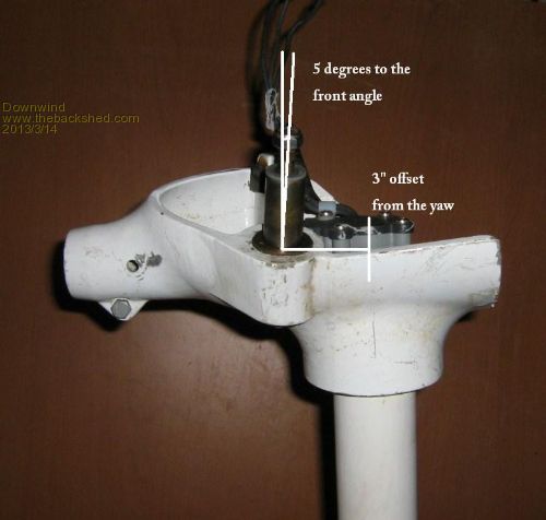

Here is some photos i took a while back of the furling angles of a Whisper.
The method works vey well as there is no tail offset and the mill always faces directly into the wind, the only real part i dont like is how the mill comes out of furl, as its a little violent with the forces in play, although i do run a much bigger blade set than the original whisper mill.
It was a free narcel with good sliprings so thought it was worth a try.
Now i have reduced the blade weight by over 5kg from the PVC GOE222 blades to wood blades the return from furl is much softer.
