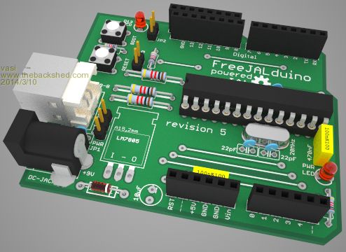

I didn't worked with it. I watched now few videos and schematics looks indeed very nice (I also like schematics made in KiCAD). The 3D part is horrible. It looks better on DipTrace.
I'm not scared by "unfriendly" programs and I adapt very well to any work flow so I can work in Eagle, KiCAD and gEDA. But I can say that I never found a program as easy and intuitive as DipTrace. Try it. You will not like too much the looks of the schematics, but I assure you that it will fully compensate with the speed in designing your project.
Unfortunately for me, there are two reasons I don't use it as it deserves:
- no linux version;
- in Eagle (with some scripts help) I can generate excellent 3D images, very good for illustrations, documentation and advertising like the one bellow:
But you can get good 3D images with DipTrace too:
http://www.thebackshed.com/forum/forum_posts.asp?TID=4841&PN =6

I agree the eagle 3D looks better but in all honesty I have never needed nor wanted 3D and even though Protel99se has 3D..
I want nice, readable Schematics and good artwork..
That aside it does have some interesting 3D views, like transparent PCB so you can see through the Board for both layers and components and a "stretch mode" so you can see internal layer connections...
