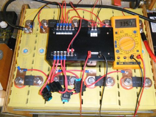

Ok, I think its time I post an update to the LiPo charge balancing idea I poste at the beginning of this thread.
Firstly, while the idea works now fine it was not without problems I had first to overcome. I'll talk you through them:
The first relays I used had DPDT contacts, there are not many of these in PCB mount variety around and they are quite expensive. Unfortunately they did not last long - contacts burned out.
Next I replaced them with SPDT relays, of course I needed twice as many (16) of them now. As a bonus it was easier to lay out the PCB for 16 relays BTW. I choose one with double the contact rating of the previous relay but still had failures. Thinking it was the inrush current of the capacitor I placed low ohm resistors in series. Only to watch them get very hot during the brief time the individual relay pair was on, fuses fitted in the lead to the cell also blew.
So, something else must be causing this and, after a considerable time scratching my head the penny finally dropped - it had nothing to do with the inrush current at all.
A brief circuit description: a 4017 counter is clocked to sequentially step through its outputs. Each output drives the base of a PN100 transistor via a suitable resistor and a relay coil pair makes the collector load of each transistor. The relays operate in pairs to get the DP contact requirement.
There is something fundamentally bad using the 4017 outputs that way, I wonder who can guess what it is? Hint, check the 4017 truth table.
Next, who can guess how I overcome this, still using the 4017 IC and transistor relay drivers mentioned above?
Anyway, its quite a simple solution and works well. I managed to find relays with an even bigger contact rating (30A) and, even better, just a quarter of the price. Look in the Altronics catalogue under automotive PCB mount relays. I also experimented with using 25F capacitors, they are quite a bit cheaper than the 100F type I started off with. The PCB was redesigned for the lot to fit into a UB2 size jiffy box, see picture below.
The sockets marked 'capacitor' connect directly to them. They allow to initially pre charge the capacitor to cell voltage before the sequencer is turned on. Then they provide a convenient place to monitor each cell voltage as the sequencer connects to each in turn - displayed on the multimeter shown. The electronics are powered from a 24V to 12V DC-DC converter which also runs other things in my set up. Running power is about 100mA relay pair 'ON', 5mA 'OFF', so averaging around 50mA.
The charge balancer does not run all the time, only when the LiPo bank is above the bulk charging cycle, thus saving unnecessary relay wear. I found a very easy way to determine that point in the charging cycle is to monitor the solar input to my MPPT controller. When bulk charging is in progress the solar panel voltage hovers around 33-35V and a small relay with suitable zener diodes in series to its coil monitors that voltage. Once the battery bank is getting full the current demand from the panels drops off, resulting in a rise of the panel voltage which in turn activates the relay. There is as much as a 10V variation so its easy to pick a suitable voltage with zener diode selection, I chose 35V so the sequencer automatically turns on as soon as the solar panel voltage goes above that value.
The relays then tick tock away, sounding just like a grandfather clock which is more reassuring than ticking like a bomb
I built two of these boxes now, one with capacitors of a combined value of 50F, the other 12.5F. When I get an additional lipo battery bank down the road I will test which is doing the job better, they both work though.
The box could be built for around $100 in parts if one has the means to do their own PCB's and materials for that, mentioned for those who are interested.

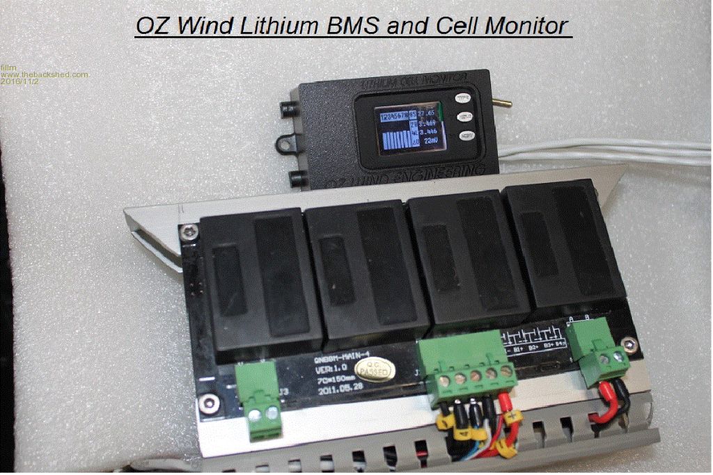

Hi Tinker ,
Just caught up on this thread,and well done for persisting. Might be interested in having a go at building one for my ultracap bank, but for 25 x 3000F that would mean 3 of these and dropping a cap.
The little diode and LED balancers work OK and have changed a couple of LEDs that were slightly different causing some out of balance, this can be tolerated because of the extra Cap giving a upper voltage point of about 68V and the cost of the cap is way below balancing but with batteries it is a different story.

Some further observations on my battery cell balancing contraption:
For the last few days the battery bank got really fully charged, the charge current was way down around lunchtime to <2A for a 600Ah bank whereas at about 7:30 AM it was charging at 30+ Amps.
Yes, the relay / supercap combination works but albeit slowly. The supercap used is 50F BTW (2 x 100F in series). The max battery charging voltage from the MPPT leveled at 28.9V and remained at that until the panels lost the sun in the evening.
The max voltage at an individual cell was measured at 3.8V with about 0.3V min/ max difference, the latter dropping slowly during the afternoon, there was still a 0.2V min/ max difference at the end of the day.
So, my balancer kept the cells well inside their upper limit. This was not so without it as I initially - before connecting the balancer - measured the cell difference and found one hitting 4.0V at which stage I removed the charge input.
I will experiment with longer 'relay on' periods in the next days and see if there is much difference.
Regarding switching currents at the relay contacts, I measured these with a clamp on Amp meter once the balancer switched itself on, (happens when MPPT input voltage rises to 36V - its around 33V when charging is flat out), and it was between 2 and 3 Amp for the 2 - 3 seconds each relay is activated. This dropped once the bank was fully charged as smaller & smaller 'packets' of charge were transferred between the cells.
With the relay contacts rated at 25A DC switching I don't think contact burnout will be a worry since I solved the relay timing problem.
It is my opinion that this device is good for 8 battery cells max, I think the time delay in transferring charge 'packets' between more cells or capacitors is too long above that number. If I had a 48V system I simply would use 2 balancers working independently, its highly unlikely that there would be much difference between 2 sets of 8 cells connected in series then.

If you are interested I can offer a closer alternative, a BMS that is continuously active and can be turned of if necessary and will easily balance to within 10mV I have Junsi's across 2 x 24V 400A/hr Winston which of course are 48V and run a charge V of 57.8, On one cell it separates 200 -300mV every cycle and is easily bought back with in 10mV in a few hrs at the upper V.. I am on the south side of Bris . I have fitted them to quite a few systems and they work perfectly in regular Off - Grid lithium systems. If you want more info contact me privately or PM .
Sorry for the hi-jack Tinker

fillm
Joined: 10/02/2007
Posts: 730
Posted: 08:24pm 01 Nov 2016
Hi Klaus,
Personally I do not have or have or had any problems with the Junsi Monitor causing imbalance, the power drawn is minuscule weighed up to the benefit of having a constant little screen to see the individual cell voltages as well as the alarm output and inbuilt pezo beeper.
All my systems have the BMS with the Monitor as shown and have no problems keeping my bank of 400A/hr with in 10mV. I have one cell that always separates and to 200~250mV every cycle and in a few hrs it is back in check.
Edited by fillm 2016-11-03
