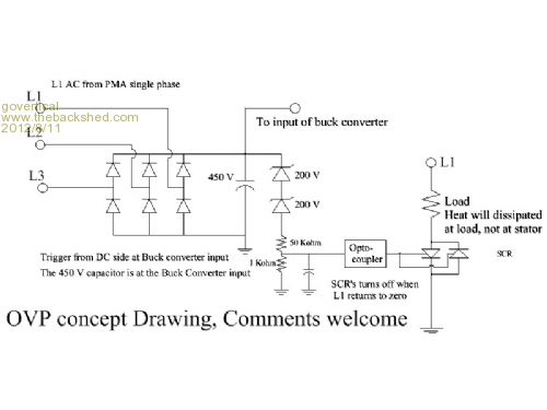

Posted: 02:32pm 07 Aug 2012

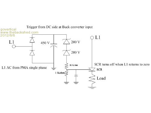

Hi, I order the parts before I understood Steve’s circuit. I do not know if the Zeners will breakdown at 400 volts. The trigger signal is from the DC side at the buck converter input. L1 is from the AC side; single phase; from the PMA. If the SCR fires it will reset when L1 returns zero. Load could be a heating element so the PMA stator would stay cool. May be a possible solution for the input over voltage protection circuit. Comments welcome
Posted: 05:06pm 07 Aug 2012
I can see a couple of problems with that circuit.
First is that the SCR will only clamp the positive ac half cycles, it will turn off during the negative half cycles.
When turned on an SCR behaves more or less like an ordinary diode and can only conduct in one direction.
If you want it to clamp both sides of an AC signal, you need to use a Triac not an SCR.
And the load should be connected between L1 and the SCR, not where it is drawn, between the SCR and ground.

Posted: 12:23pm 11 Aug 2012
Posted: 01:19pm 11 Aug 2012
You cannot connect two SCRs like that. And the resistive load will load up only one phase on one half cycle only, which will not do very much.
Your best bet would be to revert to one single SCR (as original) and connect the top end of the resistive load direct to the +ve dc output of the bridge rectifier.
The SCR will turn on, and place the resistive load directly across the output of the bridge rectifier. That will load all three phases on both halves of the cycle.
The SCR will then keep conducting until wind speed drops back to zero.
One way to turn off the SCR would be to place a switch or a normally closed push button in series with the dc load resistor.

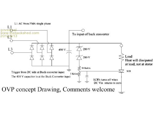

Hi, I am searching for a over voltage protection circuit for the input of the buck converter. Before I can add a micro I need the buck converter to have a rock solid operation for all wind conditions. All PMA’s are not the same, so I am trying to design the buck converter for maximum values using the parts that I have available. When the duty cycle of the buck converter is small ;less than 10 %; the input voltage can exceed the maximum value of the mosfet and it will be damaged. I have finally ordered a book on power electronics to search for a solution. I have no experience with power electronics.
L1, L2, and L3 are the outputs of the 3 phase star PMA. The max voltage value of the mosfet is 500 volts. I am searching for a OVP circuit or chopper circuit that will trigger at 400 volts.
Posted: 12:59pm 12 Aug 2012
Your first circuit was 99% there.
Ground the bottom (cathode) of the SCR.
Put the load resistor between the top (anode) of the SCR and the dc output of the rectifier.

Posted: 02:17pm 12 Aug 2012
Hi, update drawing. I have parts to test this idea. I will post results when available. Thanks for the help.

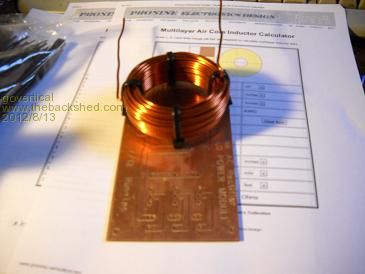

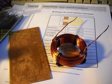

The Toroids I purchased are over heating. I was getting better results using the air core inductors. The only place I can mount them is on the bottom side of the PCB.

Posted: 02:39pm 12 Aug 2012
That should work fine.
At >400v the SCR will latch permanently on, and the load resistor can be arranged to pull just enough power to keep the voltage in a safe range.
Something like an electric radiator element would probably do it.

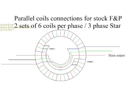

Hi, output voltage of the F&P stock coil configuration is so high it creates a problem when used with a buck converter. The high output voltage requires the duty cycle to be very small. Other projects using the F&P have reconfigured the coils to produce a lower voltage with higher current output.
Making sure that the correct wire is cut is very important and confusing. It is going to take some time.
To use the F&P with 36 coils one possible solution is to connect the coils to form 2 sets of 6 coils per phase in a 3 phase star configuration. Then the two sets can be connected in parallel.
Concept drawing is a attempt to show connection pattern, but it is confusing.
Still working on OVP circuit, thanks for the info.
Posted: 12:15pm 21 Aug 2012
One very simple way to reduce the voltage is to just split the original star junction point.
That then gives you three completely separate individual windings (with six wires total).
Connect each winding to it's own four diode bridge rectifier.
Parallel the three bridge rectifiers at the dc outputs.
That will reduce the original dc output voltage by 1.73 times, or down to a bit more than half of what it was originally.
This should be fairly simple and straightforward to do with very little chance of getting things wrong.
And you don't need to worry about the phasing of the windings going to the rectifiers.
If you need a bigger reduction than 1.73, then further segregation of windings will be required.
While the individual rectifier method of connection is theoretically very slightly less efficient than star connection, it does allow a greater combination of possible connections, and output voltage possibilities.

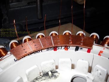

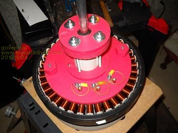

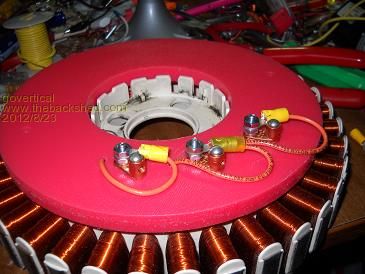

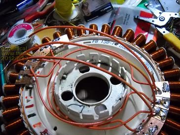

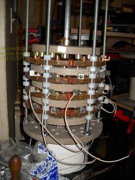

Posted: 03:14pm 22 Aug 2012
Hi, I completed F&P modification. It is now two 6 coil/phase 3 phase star connected in parallel. Replaced the spade connecters with screw terminals. Output to output resistance is about 10 ohms.
I started the modifications before I seen your suggestions.
The end caps covers the wire mess.

Posted: 05:15pm 23 Aug 2012
Hi, photo of completed assembly after modification.
