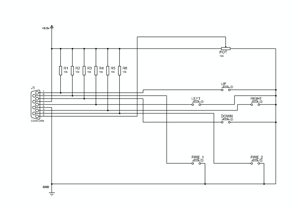

darthmite
Joined: 20/11/2011
Posts: 240
Posted: 03:36am 16 Mar 2012
Hi Nick ,
I forget to tell you that all button are pulled up with a 10K resistor.
The normal state is 1 and when you press a button you get the 0.
Here is my joystick test program :
'Amiga Compatible Joystick test for Maximite
CLEAR
CLS
'PIN 11 = UP
SETPIN 11,2
'PIN 12 = DOWN
SETPIN 12,2
'PIN 13 = LEFT
SETPIN 13,2
'PIN 14 = RIGHT
SETPIN 14,2
'PIN 15 = Button 1
SETPIN 15,2
'PIN 16 = Button 2
SETPIN 16,2
'PIN 1 = Potentiometer
SETPIN 1,1
'Main Loop
DO While 1
locate 0,0 : print "UP = ";PIN(11);" "
locate 0,20 : print "DOWN = ";PIN(12);" "
locate 0,40 : print "LEFT = ";PIN(13);" "
locate 0,60 : print "RIGHT = ";PIN(14);" "
locate 0,80 : print "BUTTON 1 = ";PIN(15);" "
locate 0,100 : print "BUTTON 2 = ";PIN(16);" "
locate 0,120 : print "POTENTIOMETER = ";PIN(1);" "
loop
here the Schematic :
Edited by darthmite 2012-03-17

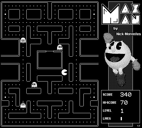

Posted: 08:14pm 26 Mar 2012
MaxMan is here!
Written completely in MMBasic for the Maximite Computer developed by Geoff Graham.
Firstly, I must stress to the programming purists out there that MaxMan is NOT an example of structured coding. It contains many GOTO statements and has heavy use of multiple statement lines. For many, the code will be very hard to understand … but I have no problem following the code myself.
This game is to be ENJOYED, not STUDIED.
Copy the files to your SD card and RUN”MAXMAN” to get it going on your Maximite.
The game supports keyboard and joystick (using Darthmite’s Atari stick specification). Unfortunately, no Wii Nunchuck (couldn’t get my nunchuck to work). More control instructions are included within the code opening REM lines.
It features arcade-like sound effects so hook up that amp!
It is designed for a VGA display, LCD or CRT (looks best on a CRT).
It requires MMbasic 3.1.
I would be curious to know if it also works on the other Maximite compatible machines.
Enjoy the first commercial grade arcade game for the Maximite!
DOWNLOAD: 2012-03-27_061443_MAXMAN.zip
Edited by Nick 2012-03-28
