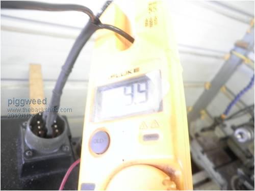

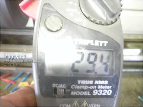

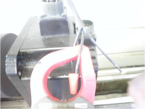

Well I shorted two leads together and with back gear ingauged my Boxford vsl would slip so I spent all morning shortning the linkbelt, what a pain. With two leads shorted ( L1 & L2 ) and clamp on amp on L1 @ 200 rpms I get 10 amps, at 250 rpm I get 14 amps. I printed out Don B's testing post and will test further. Is that what you meant shorting the leads to get amp reading?
piggweed
Joined: 09/01/2012
Posts: 29
Posted: 07:02pm 13 Jan 2012
Here the amp reading at 550 rpm, not sure if I am testing right, and the way I am testing amps. What say ye.

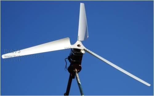

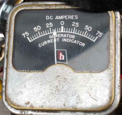

Here are some pictures of one of my servo's on our test stand; using 80 inch Windy Nation wind grabbers and a pair of hard used mobility battery's paralleled for a 12 volt load, wind this day was gust to 20 mph its a 9 amp 165 volt servo.
I was pleased with the output and the way it followed the wind and I tried to capture the amp meter with my then new camera during some gust.
Maybe this will help ease some doubts as piggweed has a much better motor than this. I'm sure it will work once its up and flying and with piggweeds welding skills should stay up a long time.

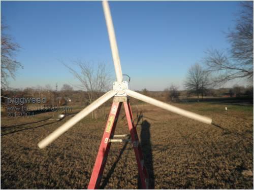

isaiah, I whipped out these just for testing, wasn't sure if they would work. They are mad out of 4" sch 40 pvc pipe I had in the barn, each blade weighs 451.3 grams. I thought they might be to flemzy, but seem to be working. At the hub they are 3 /34" and at the tip 2", and the hub is made out of delrin (already had the delrin). I have no idea what they will do in high winds. I am sure they are not as effecient as they sould be, I have been looking at blades and how to make them. I would like wooden blades but wood working is not my strong point. I can build anything out of metal, but with wood i'm like a bull in a china shop.

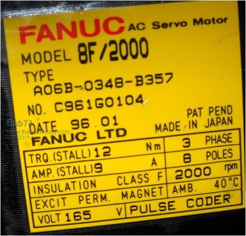

For me there is much to be leaned about using servo motors as wind turbines.
There seems to be no easy hard and fast rules for determining their output by the tag numbers mostly they just work. The answers lay in the manufactures spec sheets like 97fishmt posted and theory such as DonB has posted in this thread.
I have two others that don't follow the rules, one a small 2000rpm sanyo that wants a much higher rpm to cut in than the numbers indicate. The other a 3000rpm getty will deflect an amp meter hooked to a 12v battery and turned by hand, just turned not spun by hand.
They both will work with some effort I'm sure; the small sanyo is doing a good job now keeping a string of reclaimed battery's topped up by going with faster blades and a buck booster as the other Bob on the forum has done with his Chinese mill. The getty I haven't dug into much yet as it is heavy and mid winter here.
