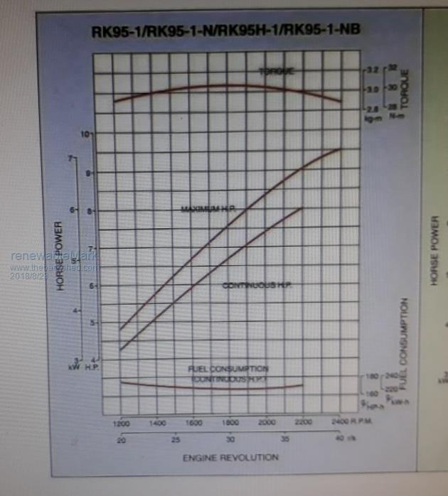

You can reduce the RPM of the Diesel, it will run more efficiently. Have look at the manual for the Engine it should have a kW output verses RPM chart.

The graph only goes down to 1200 rpm, I'll see how it goes at a lower rpm as it will obviously make less noise.

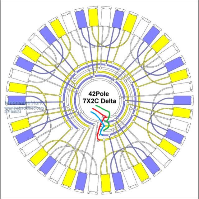

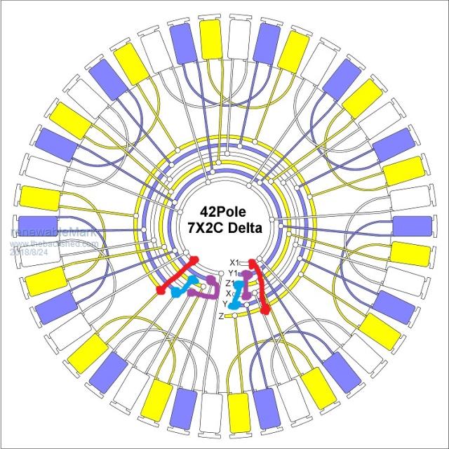

Just looking at the wiring diagram and schematic, so for delta it needs both the start and finish lines connected together correct?
Like this?
Cheers Caveman Mark
Off grid eastern Melb
Posted: 09:20pm 23 Aug 2018
Each red etc is doing exactly the same thing in your diagram, nothing wrong with that but if the wiring used is sufficient then the duplication is not necessary.
Then connect each of the red, green and blue to a 3 Phase Rectifier, if you go with a dual generator (which I think you will need to) then you need 2 rectifiers as well and keep the 2 generators separate until the output of the of rectifiers. You could also use the DC - DC of one of my regulators or use one of the Regulator Auxilary outputs to turn off the engine once a set battery voltage is reached. For example, have a solenoid that is turned on below 59V, once 59V is reached the Solenoid turns off and the engine stops. I can give you the code required if you decide to go that way.

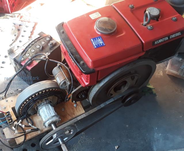

OK revved the diesel to full power and only got 58v open circ from the 7x2 delta,
I'll try it in star next, but was wondering if just using an induction motor would be easier?
Not too sure how to go about that though.
pulley on motor is 110mm OD, pulley on FP is 180mm OD.Edited by renewableMark 2018-08-26

Well the diesel runs at 2200 so if my math is correct the FP should have been doing 1375rpm.
Sadly the pulleys have a different shaft diameter, so I'll have to buy new ones or different wiring.
Or an induction motor, from what I can see, all you need to do is spin them faster than their rated speed and provide some charged caps to excite them to initialise the process.
Seems a lot easier, hook that into the 240 line and backcharge.

I only hooked up two phases and got max of 500w, looks like the little turd needs to be spun faster for that wiring.
Might wire up another differently and get some different pulleys, ideally the motor would be run reasonably low revs.
