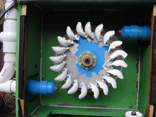

Glad to hear that you have been able to make such a substantial improvement in output. I wonder, though, how you are measuring the Watts out? Measuring AC Watts can be tricky, particularly with a 3 phase set-up, which I think that you now have up to your house. If your measurements are after the rectifier (ie DC), then you should have a fairly accurate figure.
Looking at the photographs of your nozzles, it looks as though you are now using a relatively short linear taper, although perhaps you have a different shape inside the nozzle. I am no expert, but I imagine that the most efficient shape for obtaining the maximum combination of flow and velocity from your head would be either a fairly long linear taper, or something shorter with a non-linear taper like half a venturi. Maybe having a look on the internet at "nozzles", or "nozzle design" would suggest the most appropriate shape and dimensions for your head and flow rate.
With regard to doing something useful with the power, the suggestion to use the power to charge a battery, and then draw off the battery perhaps using an inverter to run your AC appliances is probably the best one. The only problem is that you have a relatively high and probably variable AC voltage of unknown frequency, and a three phase supply.
Some modern switchmode battery chargers can probably accommodate a reasonable range of input voltages (as long as they are not above its rated voltage), and should not care particularly what frequency they are supplied with. This is because the first thing that a switchmode battery charger ordinarily does with its input voltage is to rectify it to DC.
The only bother is that, with a 3 phase supply, you would probably need one charger on each phase. Using 3 chargers connected to the one battery should not be a problem, so long as the chargers are all the same make and model, and have identical settings
The battery chargers should hopefully control the battery charging, so that the battery is kept properly charged. As each charger need only be, say, 60 Watt rated, they should be relatively inexpensive.
You would need to took carefully at the charger specs, and maybe confirm the suitability for your application with the manufacturer.
If you select 12 Volts, or even 24 Volts as your battery voltage, then you have a wide range of DC gear available that would not need an inverter to give you useful power from your set up. The only thing to watch with low voltage DC is that voltage drop can be a problem, and you need to use heavy gauge wiring for satisfactory performance.
You can also readily get 12 or 24 Volt inverters to run your (small) AC appliances. Be aware though, that you will not be able to run high wattage appliances like a microwave or toaster, or an AC fridge. Remember also, that if you are only able to generate a steady 100 Watts or so, your average power draw can only be something less than this.

Hello Friends,
[quote=Don B]Measuring AC Watts can be tricky, particularly with a 3 phase set-up, which I think that you now have up to your house. If your measurements are after the rectifier (ie DC), then you should have a fairly accurate figure.
Looking at the photographs of your nozzles, it looks as though you are now using a relatively short linear taper, although perhaps you have a different shape inside the nozzle. [/quote]
I am finding out that everything can be quite tricky, I was using a combination of 3 phase and rectified (DC) and I question the accuracy of my results. I am still awaiting the arrival of my clamp on amp meter and tachometer. Until then, I think that I will reserve posting any test results. I hope they will not be to far off.
The nozzles are formed by using the end of a plastic soft drink bottle, which is cast, with body putty, in the end of the 2" PVC pipe, and forming a nozzle which is the exact shape as the bottle. The inside of the nozzle is now the bottle itself. It probably want last very long, but is cheap and fun to make. I can experiment with many different sizes and shapes to get the most effecient.

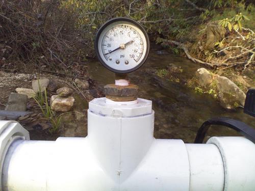

Posted: 11:04pm 12 Dec 2011
John,
I have been thinking about this a fair bit, and here are a few random thoughts.
Hydro is very unlike wind power or solar, in that the water head and flow will not change, provided there is enough water to completely fill the penstock in the first place.
Therefore electrical output is going to remain very constant, unless the system starts to go dry on you.
That means you do not have all the problems associated with constantly fluctuating voltage or current, and it greatly simplifies battery charging, because you can match the generated voltage to the battery experimentally for best power transfer, and it will then stay pretty well optimal without having to change anything.
Measuring dc watts after the rectifier, which is what I am assuming you did, is perfectly valid, and a much more useful figure to have.
So don't go through all the mental contortions of trying to measure anything on the ac side, it is really an unnecessary complication.
As the overall efficiency is already so admirably high, I doubt if the losses in your penstock and nozzle are significant. One interesting test would be to measure the static water pressure just ahead of the nozzle with the flow blocked, and with the turbine flowing. A transparent rising water manometer tube may be the simplest and most accurate way to measure this, and it will tell you the pressure drop in your penstock.
The penstock pressure drop figure may be useful to know if you plan to design a larger system in the future.

Hydro John
Hi
Looking at some of your older posts, I see a detail that could possibly improve on the torque of your Pelton ( unique use of Elbows) !, DETAIL, The picture of your box and wheel with modified Nozzle, The Jet stream from the Nozzle may need to be a bit lower down ( nearer to a tangent to the turbine cups) maybe down 3/8", I say this because I have read various documents about the design of Pelton wheels and the principal of energy transfer from water to wheel,
The Idea being to totally reverse the direction of the water, when the jet hits the cup, the rebound is smooth and quick. the concave surface of the spoon or cup reverses the water direction completely. I notice that on your Wheel the jet is cut off by the Cup following, before the tangent cup has reached its position to fully reverse the Jet,. The Cups are exhausting water vertically at only 45 Deg.
Moving it down may mean that the nozzle would need a longer taper to position it close, don'no.
You are the man with the Machine and I just an onlooker, It could be that the Elbows have a different reaction than a standard Pelton Spoon. I thought it worth a mention.
Great work here, would like to see you get the rest of your available head.- ----------------Cheers, Roe Edited by Greenbelt 2011-12-14

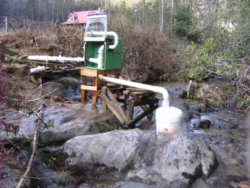

Hello Friends,
[quote=Greenbelt]The Jet stream from the Nozzle may need to be a bit lower down ( nearer to a tangent to the turbine cups) maybe down 3/8", I say this because I have read various documents about the design of Pelton wheels and the principal of energy transfer from water to wheel, [/quote]
I have tried many different positions and the one pictured below seems to give the best results.
I have come up with a way to measure the flow through the nozzles. This should give me more accurate information. I can now measure the real flow rate using different size nozzles.
[quote=Warpspeed]One interesting test would be to measure the static water pressure just ahead of the nozzle with the flow blocked, and with the turbine flowing. [/quote]
I have a simple water pressure gauge installed,although I don't think that it is very accurate. The picture below shows about 9 psi static pressure, which is very close to the calculated pressure at 21' head.
From all the testing I have done so far, it is beginning to look like the F&P generater I have is not going to be able to effeciently use much more than 50 GPM at the 21' head I presently have. I think I have enough water to run at least one more generator and I am thinking about building another one. My question is, can I connect both 3 phase generators to the same line going to my house?

Joined: 31/10/2011
Posts: 35
Posted: 03:05am 15 Dec 2011
Hi Tony,
Current conditions:
Head = 21'
Flow = 52 GPM
Using 1 nozzles @ 15 mm
No load line voltage = 362v
Loaded line voltage = 211v (loaded with 3 - 40 watt bulbs 3 ph Y)
Can't measure amperage (still waiting on amp meter)
Have about 2 volts line loss from generator to house.
Hydro John
Posted: 03:26am 15 Dec 2011
That is excellent John !
If you add a three phase rectifier to it, the 211v RMS ac loaded voltage per phase should increase to roughly around 290 volts dc (loaded) coming out of the bridge rectifier at about maybe half an amp dc at 150 watts.
The voltage is high enough to significantly reduce line losses, but not inconveniently high. A couple of volts line loss is insignificant.

I'm still searching for new ways to improve my pelton wheel and nozzles. The buckets on the original wheel cannot take the continuous pounding of the jet stream, and some of them are beginning to get loose. I have some ideas on how to strengthen them and will let you know how they turn out.
Thanks for all the help and encouragement.
