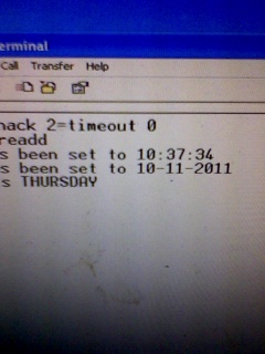

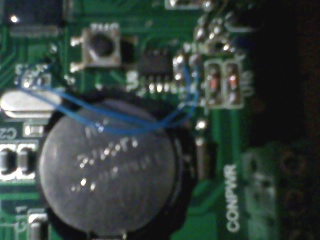

sparkey
Joined: 15/06/2011
Posts: 819
Posted: 11:04pm 09 Nov 2011
here is a pic of my "SM1" board running the rtc
Edited by sparkey 2011-11-11
