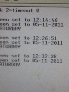

Posted: 01:09pm 03 Nov 2011

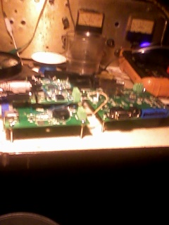

well i finally have the "rtc " running it wasent turnig over the date i will post the 2 zip files i am using the only disadvantage is that the clock runs in 24 hour mode but thats not to be snezzed at it is on the SM1 board from don running the 8653 chip ...///.../// i think i am using gerards code but there have been so many posts of the code well this is working for me will zip up the files and post .../// heres a pic of the sm1 board i picked up to day i am waiting for the discreet components to arrive hope fully to morrow i have put 25 mm m3 bolts as stand offs as this will be my test rig for what ever i find to mod on it
in addition i would also like to add that i am going to use the con 3 connections rather than the i/o pins as i dont favor the idea of using up these pins ...///...///

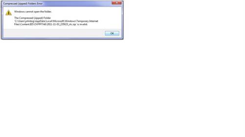

Hi Sparkey the zip file is invalid.

sorry about that yes ut seems that one of the files is blank i will fix it shortly please dont respond as i want to edut this pasge i just woke up ....///...///
this should work2011-11-04_091329_2011-11-01_170454_8563.zip Edited by sparkey 2011-11-05

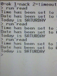

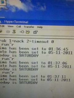

well this is the rtc files it seems to work although its midnight and i am not shure weather the clock is set to 12 or 24 hour mode but it does work...///...///
2011-11-04_230826_rtc.zip
i just set the time to 12:16:00....so if it turns over at lunchtime it will be presting 12 hour mode.... well have to wait till then...///.../// also it reads the day correctly its saturday now...thats what i enterd since ...///...///
also would like to add i did this with the battery fitted just st the correct time and date from the command line
next run"setime ...follow the prompts " then hit enter....
then run the "read" program and every thing should display in front of you ...///...///Edited by sparkey 2011-11-05

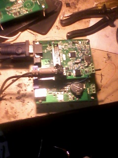

here is a pic of my blown up SM! board with the "rtc" components running ..isolated from the faulty cct of the "SM1" with my "EV " board mounted on top of it and hard wired vga video and a k-b sckt that i removed and cable tied up to the usb conn....the time clock is running and so there you have it a fully working maxi it has all the features working...///...///
the clock is still running in 24 hour mode will have to look into this but ...i`m tired and it wont be tonite..it could be that i have some of the code wrong and as i am running the "8563 chip it may only run in 24:00 mode i dunno ..././//...///

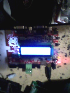

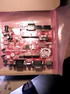

Posted: 12:10am 16 Nov 2011

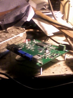

here`s a pic of my latest addition.to add to my collection.....lets have some fun HMMM wonder what i can create with this
Edited by sparkey 2011-11-17
sparkey
Joined: 15/06/2011
Posts: 819
Posted: 12:33am 16 Nov 2011
and here`s it with an lcd sheild...
donmck
Joined: 09/06/2011
Posts: 1314
Posted: 12:35am 16 Nov 2011
  sparkey said   and here`s it with an lcd sheild...
did the existing code work sparkey?
