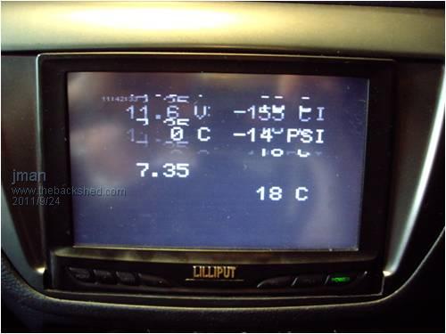

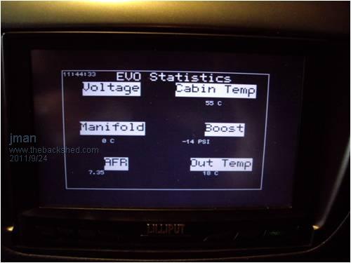

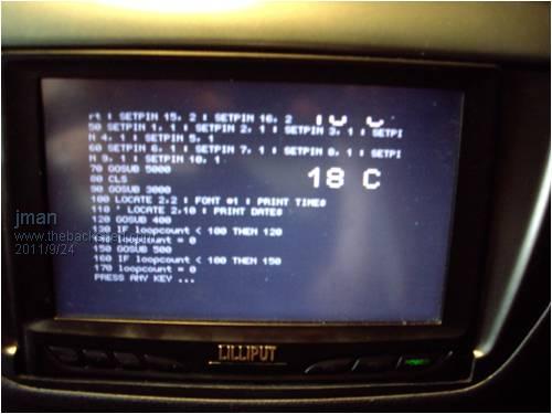

Hi All
Has anybody tried the new fonts with composite video ?
I seem to have a problem with the display getting all muddled up
when using the fonts. My old code (no font command) works fine
in VGA mode the display is as expected
The bit from 3060 - 3130 works as expected this only run once at startup
the bit from 4000 - 4070 produces the odd display only on composite video
this run in each pass
3060 PRINT "EVO Statistics"
3065 FONT #1, 2, 1
3070 LOCATE 30,20 : PRINT "Voltage"
3080 LOCATE 165,20 : PRINT "Cabin Temp"
3090 LOCATE 25,90 : PRINT"Manifold"
3100 LOCATE 210,90 : PRINT"Boost"
3110 LOCATE 60,155 : PRINT"AFR"
3120 LOCATE 190,155 : PRINT "Out Temp"
3130 RETURN
4000 ' rem print
4010 FONT #1, 3 : LOCATE 35,50 : PRINT volts$ +" V"
4020 LOCATE 210,50 : PRINT intemp$ + " C"
4030 LOCATE 177,120 : PRINT boost$ + " PSI"
4040 LOCATE 40,120 : PRINT exhtemp$ + " C"
4050 LOCATE 30,179 : PRINT AFR$
4060 LOCATE 210,179 : PRINT outtemp$ + " C"
4070 RETURN
Garbled display
Display of 18 remains even after doing a list
Layout with fonts is all good only goes odd when running
the value display code
Edited by jman 2011-09-25

Posted: 01:38am 24 Sep 2011
John,
The problem is probably caused because you are not using a semicolon at the end of the print statements.
Without the semicolon a line feed will be outputted in the current font. The firmware will see that the line feed goes beyond the bottom of the screen because the font is so large, so it will scroll the screen upwards... not what you were expecting.
The moral is; with large fonts use a semicolon.
Was the cursor at the top of the screen when you had the display of 18 remaining even after doing a list? That would be normal, list does not clear the screen.
GeoffEdited by Geoffg 2011-09-25

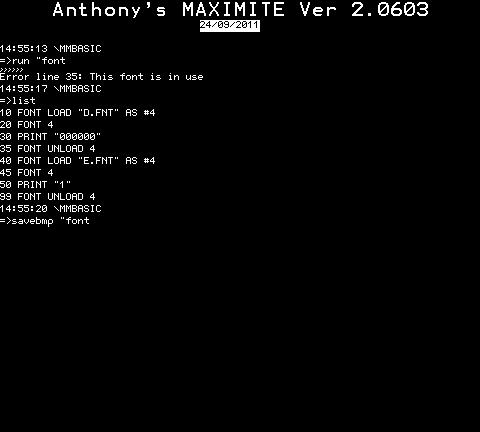

Geoff,
Font unload is not working
Error line xx: This font is in use
See attached jpg. Ignore the "header text" it is from my Autorun.
Also the link for version C is incorrect, you have linked version A.
Cheers,
Anthony.

Posted: 06:12am 24 Sep 2011
  Geoffg said   John,
Many many thanks you are course spot on
Made the change and now the display is working as expected
Updated Pics in the orginal post

Posted: 11:16pm 24 Sep 2011
Anthony,
I have just had a look at your screen shot and the font command is doing what it should. You have the font selected when you do the unload so it correctly reports that the font is in use.
Before you use the font unload command you should select another font. eg, FONT #1
