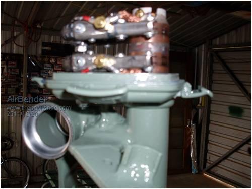

Dean, I thought you might want to solder connect the brushes. Just be very careful how you do it - that fine wire acts like solder wick and you can have the whole pigtail solid in no time. I suggest you use a big soldering iron, ~80W, and hold the brushes in a clamp so that the tails hang down. Do the soldering as quick as possible.
You might have known the above already but then maybe not .
The pro's spot weld the brush tails to a lug for connection.
If this was my slip ring I would use those brass 2 screw connectors as found in mains electrical connectors instead of soldering.

Thanks Klaus and Rastus,
While looking at the above picture I think I should try and cut some holes in the lid of the container and fit it onto the bottom. it has 4 clips around it and has a rubber seal. I think when I get rain with wind the blades will chop the rain up into mist and the mist will waft up inside the container.

Rastus
Joined: 29/10/2010
Posts: 301
Posted: 10:50am 14 Oct 2011
Hi Dean,
Capillary action of water is fasinating.It can be drawn uphill with no apparent force,so waterproofing is a must.Cheers Rastus

Hi Dean,
Further on connecting the pigtails. If you can borrow a swaging tool that might be the way to go - no soldering. They're similar to car type wiring connectors but bigger (different sizes are available) stronger and make better contact. You'd also be able to stuff all the braid in easily. The connectors themselves are available in copper too. Commonly used by yachties and also for those stainless steel wire balcony "rails".

Hi all.
I have some crimp on terminal lugs at home, I might need to open up the bit that crimps around the wire a bit to fit the pig tails in. Im not bad at soldering I thing the trick is to apply the heat to where you want the solder to run and like Klaus said do it quickly as the more area that is heated up the more chance there of solder running where you dont want it to go.
I think I will need to remake my cover, now that I am going to put the lid on the bottom of the cover, the lid is what I should have the brackets conected to, and then the cover can be held in place by clips on the lid. I have drilled holes in the cover now so I will go up to the supermarket and buy a new one, they only cost a couple of dollars.

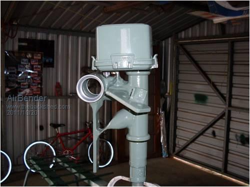

My second attempt at a cover was abandoned after I fitted the blade hub the chain was rubbing on it , But my third attempt has worked. It has been harder to fit a cover than making the slip rings.I have added some brass terminal bolts to the brush arms but that is about as far as I have got. We are a couple of guys down at work so all I have been doing is working sleeping and going back to work again
All the best Dean.

Slip rings and cover are finnished, and new bearing cups have been fitted. Bike cranks tend to wear uneven, the old bearings had a slight wobble. Any movment in the shaft causes the chain to go slack and then tight as it rotates. 14 dollars spent on the new bearing set will be well worth it at the end of the day saving on chain wear and bearing wear in the DC motor.
I have just got a bit more painting to do and a final asembly and then I need to look at getting a pole. I am looking at a 7m pole that will put the hub level with the top of the vawt wings. Pole wire and cable will be the most expensive part of the build.

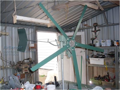

The wind mill was full assembled this afternoon and is ready to go up when I get a pole. The hub runs very true with the new bearings and the chain runs smoother than it did on my last test. the blades were only roughly shaped up and wernt balanced on the last test so I might get a bit of improvment on performance when it goes up.
All the best Dean.

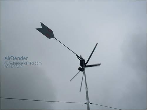

The pole is up and I lifted the mill up for a test today. I still dont have a wires running down the pole yet but it spun up very fast in 15-20 km/h winds. I am looking forward to wiring it in so I can see what kind of power it is puting out.
There are a few different 24v dc motors out there that I might test down the track when I get my hands on them, as I beleive I am getting high enough rpm to run most of these motors.

The mill is back in the shed untill I get some wiring in place.
Later this afternoon we got some stronger gusts come through at over 20km/h, the mill was screaming with no load on the alt, the tail started moving in of its stop a bit, so I may have this set up close but I wont know untill I get a load on the alt to see if it is furling to early, but if so I might try adding a bit of weight to the tail.
