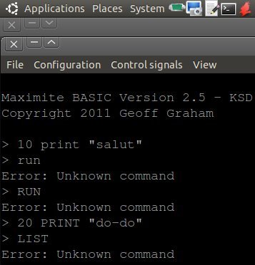

I loaded the chipKIT Max32 MPIDE software on my linux computer, running Ubuntu 10.10, and tried installing the Maximite-2.5-ksd-ChipKit-Max32.hex file.

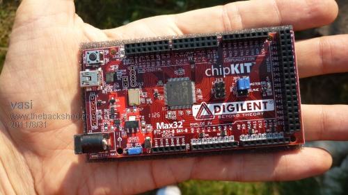

My board must arrive in a day or two, then I will be able to find a solution. First, compiling the Gerard's version (which will require making a minimal shield) using an .ld file for Chipkit, then, to see if I can manage to modify it for mass storage (and that means another shield). Of course, Ken's sources will be of some help.
No promises but it is also my interest.

I can confirm, avrdude is crashing on both Windows Vista and Linux Ubuntu 10.10 .
I have a warning from the linker:
[code] C:\Apps\Microchip\C32\bin\..\lib\gcc\pic32mx\3.4.4\..\..\..\ ..\pic32mx\bin\ld.exe: warning: cannot find entry symbol _reset; defaulting to 9d001000[/code]
The entry is missing from the .ld file provided with Chipkit Max32. Is that a reason to worry, the default address is ok?
Man, I have a lot to learn about this board.

Hi ArtBecker,
Can you try this .hex file?
2011-09-09_122816_Maximite.X.production.hex.zip
Is a compilation of Maximite 2.5 source with MPLab X and C32 v2.01 under Ubuntu. I had a successful upload on my board but I'm not yet able to test it as I need to build a Maximite compatible shield. I didn't touched the source (in the hardware compatible sense, otherwise I had to correct some case sensitive file names and paths). I will when I will have a proper shield.
Vasi

As I don't have the hardware ready for the original MMBasic, I compiled the sources of Ken where it uses UART2 for console and at least, I have a prompt:
I will start hunting the error and also will try to "restore" the sources of the last firmware of Ken because are incomplete (and not compilable).
