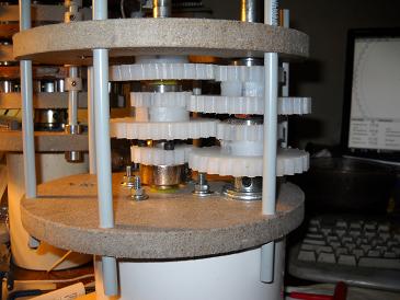

Hi, I completed the gear drive. It is very noisy. As I added more gears the noise increased. It makes to much noise for my application. Because the increased RPM is needed for the project I am going to use the same technique with belts and pulleys. Comments welcome.

Hi Govertical,
The pic' may give an optical illusion,the gears don't appear to be perfectly flat,which stops them running true and will add to the noise.The gear material possibly flex's at contact surfaces and the bearing,if they are roller will also add to chatter noise.Alluminium machined gears with dry lubricated close tolerance bush bearings will keep the weight down and reduce vibration is a guess I'd make.

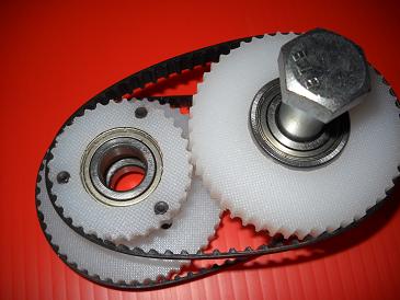

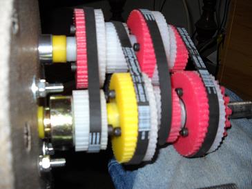

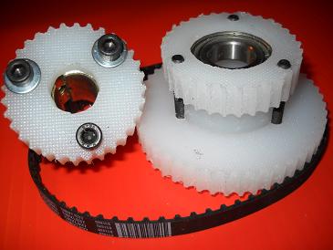

Project update:
I am able to fabricate the cogged pulleys that are required. Adding idler pulleys will be challenging. I have to order larger diameter timing belts so the pulleys can be a larger diameter to allow better bolt hole placement. Comments welcomes.
Posted: 01:45pm 17 Sep 2011
Interesting that you went to the trouble to machine your own timing belt pulleys. I purchased some from a company (RS components) here in Australia, they were made from aluminium and have shoulders to prevent the belt from slipping off.
With your version you need to have very precise shaft alignments, especially if one pulley is very large. I would suggest that you make the shaft on one side movable to allow belt tension adjustment, I found the small belts stretched quite a bit by the load my solar tracker put on it.

Hi Govertical,
The update looks great!Choosing the belts and cogged pulleys should absorb a lot of vibration and reduce undesireable noise levels.Do you have something in mind for idler pulley's? All the best Rastus

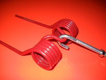

Posted: 07:32pm 17 Sep 2011
Hi, making one shaft move so all the belts tighten at the same time will require the least amount of parts and is easiest to fabricate. Thanks for the suggestion. I found a tooth rake that is used for agriculture that will function as a torsion spring to move the posts apart and provide a constant tension to the belts over time. It will a few days to fabricate all the parts. Thanks again and enjoy the day.

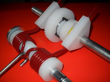

Joined: 11/12/2008
Posts: 383
Posted: 07:46pm 18 Sep 2011
Greetings, just some photos of torsion spring yoke assembly. I still have to cut slide holes in the mounting plates. Enjoy the day.
Posted: 12:58pm 19 Sep 2011
Some nice work there govertical, any chance of a picture of the machine you use to cut the belt pulleys?
Rastus
Joined: 29/10/2010
Posts: 301
Posted: 02:22pm 19 Sep 2011
Hi Govertical,
Is there any possibility that the spring can start to bounce in operation as the belts stretch,resulting in belt loss or at the least some drumming.Constant tension monitoring could become frustrating.The build quality is first class!Cheers Rastus

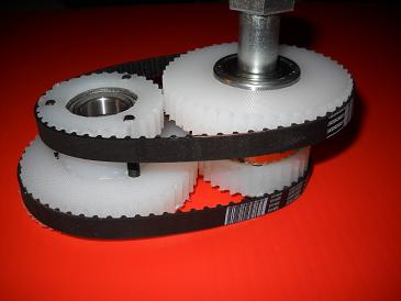

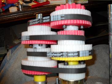

Posted: 07:16pm 22 Sep 2011

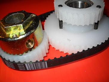

Greetings, I still have to add spring shaft adjustment to tighten all the belts at the same time. I made the belt pulleys double the width to allow for easier belt to pulley alignment, this will also allow the belts to self track. Fabrication of the first one is going slow but so far the results appears to indicate that it will work. Enjoy the day.
Perry
Joined: 19/11/2009
Location:
Posts: 190
Posted: 07:42pm 22 Sep 2011
Looks good.
If you put metal disks on either side of the machined pulleys it would help keep the belts from jumping in case you lose alignment. One belt pops off and you have a free-wheeling rotor and no way to keep it from overspeeding.
