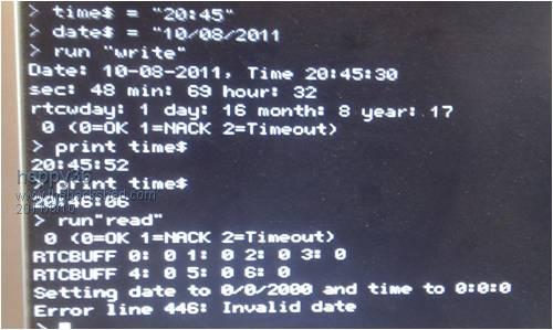

When say disconnect battery,will removing the jumper do,or should I un solder it?
it seems to write ok but when I read,also if i just write then turn off it forgets
it seems to write ok but when I read, also if i just write then turn off it forgets
Hi.
I do not have one of these eBay RTC devices, so I am not certain if the battery is permanently in circuit or not.
When you disconnect power and remove the jumper is there any voltage on pin 8 of the PCF8563 IC (measure from ground to pin 8)?
Either way, looking at the datasheet the control registers can be set to default values by writing them. Replacing the following line in the code will also update the control registers:
725 I2CSEND i2caddr, 0, 10, 0, 0, 0, seconds, minutes, hours, day, rtcwday, month, year

Thanks for code update Gerard i set my 8563 registers previous to using wr8563
I can confirm this line fixs the register setup problem

Thanks Gerard,but its still the sames as the Pic I sent,I think my ebay unit was probley a friday one,I will order another as other people seem to be working fine.
I was going to get 2 (should off)
Thanks again for all your help,realy is a appreciated

While it may be a dodgy unit, if you would like to send the unit to me I will put the logic analyser on it and check what is being sent and received from the unit. I will send it back with the results of the test.
If this is of interest send me a private message (PM).

I have tried the below code (with Gerard's fix) on a never before used chip and it works
To set the time and date

Thanks I gave it try ,but still no luck.
Gerard if you message me your details I will send it to you,see if you can see if it me or it!!

I received your RTC module today and have connected it to one of my maximite's, as well as to the logic analyser.
It is working beautifully! It is keeping time and all the I2C data communications are correct. I am running it off the internal battery.
I also connected a scope and frequency meter to the external clock out pin (along with a 30K pullup resistor) and it is showing a nice square wave at 32.76892kHz (which is a little fast - it will gain time at around 1 second every 10 hours).
I will send it back to you tomorrow.

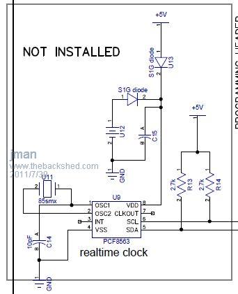

This device is connected just like any other I2C device
Pin 12 maps to MCU pin 43 (SDA1) and pin 6 on the I/O connector (revised schematic) or pin 21 (original schematic).
Pin 13 maps to MCU pin 44 (SCL1) and pin 8 on the I/O connector (revised schematic) or pin 19 (original schematic).
The PCF8563 has built in pullup resistors to the VCC line so no need for those
You can get +5V from I/O connector pin 23 (revised schematic) or pin 3 (original schematic). A ground will also have to be run to the I2C device (I/O connector pins 1,2,25,26).
This device will also run from 3.3V in that case pin 24 (revised schematic) or pin 4 (original schematic)
So the short answer is yes the I2C signals are avaiable on the 26 pin connector
