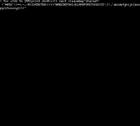

Interesting discovery:
While on the subject of screen codes, I typed the following line into the Maximite using its attached PS/2 keyboard:
FOR X=32 to 255: PRINT CHR$(X);:NEXT X
On the VGA monitor, I get one line starting with the space, and ending with the ~ character. On the PC screen (using TeraTerm) I get two lines, the second has the extended codes such as line drawing, accents and the like.
Strange behaviour. Why the discrepancy, I wonder?

Posts: 2984
Bob,
I think you will find the VGA does 2 lines but all of the chrs from 127 to 255 are BLANK and not defined... Tera Term presumably has standard IBM codes for those Chars.

Posted: 06:23am 21 Jun 2011
Mik,
No, the VGA monitor only prints one line, no blanks, just no output at all.

Posted: 06:26am 21 Jun 2011
Yeah thats normal. The Maximite doesn't know how to draw the characters after 126 (~), so you see blanks. They are there, you just dont see them, cause they are blank.

Posted: 06:35am 21 Jun 2011
Sorry to tell you you're wrong, Glen.
If I add the command PRINT"hello" directly after the for next loop, the word "hello" is printed directly after the tilde (~) character. No evidence of any blanks.

Posts: 2984
Posted: 06:46am 21 Jun 2011
  BobDevries said   Mik,
here's a screen shot:
In that basis I would suggest that they just print "NULL" which would not print anything or take up any space....so they print 128 NULLS .

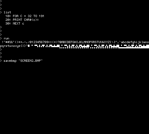

Jimbo
Posts: 8
Posted: 10:03am 21 Jun 2011
In the interest of TRS-80 / System 80 basic compatability, I implemented the TRS-80 graphics character set. This extended graphics set divided each character into six, giving 2^6 or 64 graphics characters ranging from blank chr$(128) to full white block chr$(191). (See the screen shot attached) These chunky graphics can set the video memory faster than pixel, by pixel, but can be mixed with the pixel/pset/preset commands. Just like in the good old TRS-80/System-80 days.
Just as a side not, in extending the character set, I found that the source code for the stock firmware doesn't output characters greater than ~ ASCI(126) to the VGA buffer at all. Since they have no font defined for them it skips them.
