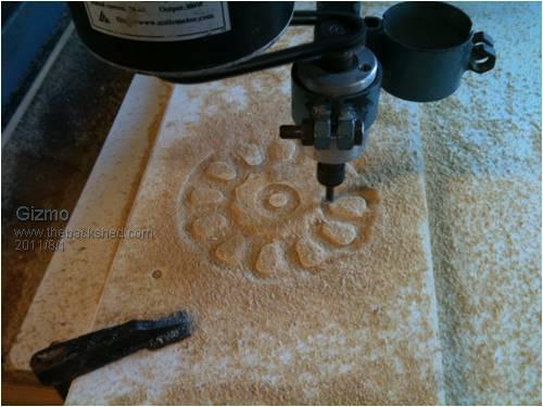

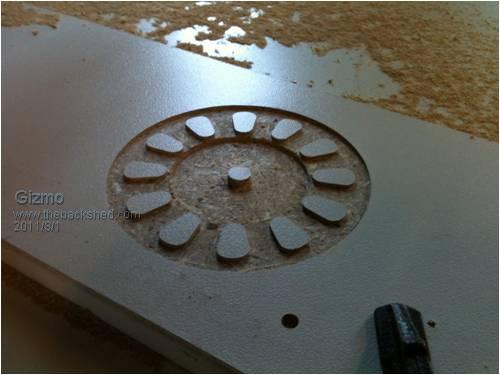

Posted: 06:55am 01 Aug 2011
Some more work towards the axial today. I want to try a few idea's on this thing, one was to use my CNC router to make the stator mold. After sorting a few bugs out of the CNC, today I finally did something useful with it and made a half scale mold. I wanted to test the g-code before letting the machine loose on some 25mm thick MDF.
This one is only a few mm deep, the real one will be 10mm deep at the coils and 16mm deep at the mounting ( center ). The center of the coils is left raised to help position the coils precisely. Its only a low power alternator, and the coils will be embedded with epoxy, so I can leave the holes in the stator I think without it loosing too much strength.

Posted: 09:58pm 01 Aug 2011
Nice work Glenn. You are a very clever person ..
I look forward to seeing what forum guys get up to, just amazes me the talent that abounds on this forum.

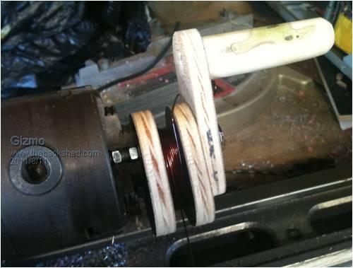

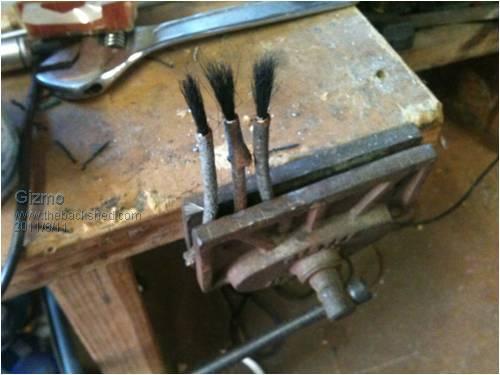

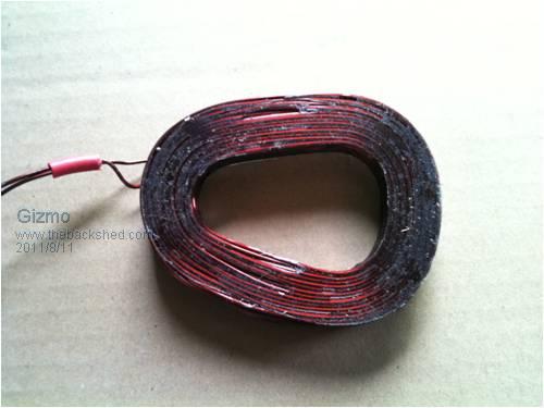

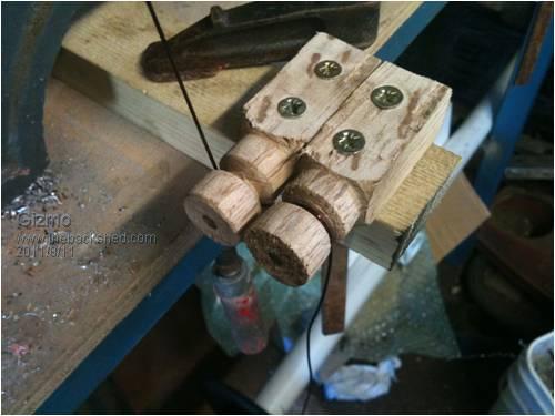

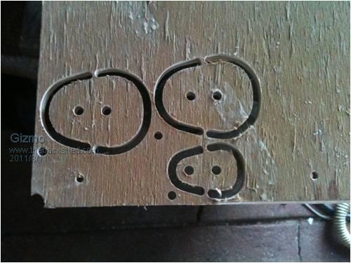

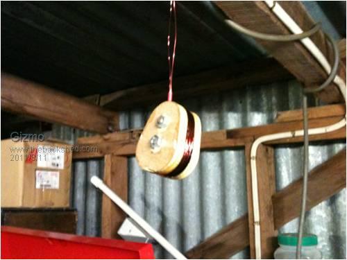

Posted: 01:17pm 11 Aug 2011
Just an update.
Picked up the copper, and started winding coils.
Used the CNC to make some coil formers.
This is the wire tensioner, it works brilliantly!
Phills suggestion, make some little paint brushes for laying down the epoxy as I wind the coils. I found some twigs in the yard and hairs from a old paint brush.
Winding the first coil. I ended up using the lathe to support the coil former.
After winding, each coil is allowed to cure, about 12 hours.
Finished coil.
Each coils has 140 turns of 0.9mm wire. Its a tight squeeze, in hindsight I think it would have been a lot easier to use 0.8mm wire, but this would mean less power in the end. I've only got 3 formers, so it will take a couple of days to make all 12 coils.

Posted: 03:33pm 11 Aug 2011
Hi Glenn,
Top marks for the tight,evenly wound coils!Jealous of how usefull the CNC is as well,Cheers Rastus

Posted: 09:19pm 11 Aug 2011
Hi Glen,
There is alot of good suggestions and ideas in you'r post. I like the way the coils are very tight and uniform in size/shape to each other. As I understand it, all coils will be wound the same direction, is this correct? And about the epoxy, is this the same stuff used by manufactures of electic motors? Sorry to bother you with a million questions. Everything looks top notch and very proffesional, good work Glen.
