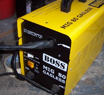

Dwyer my welder is a 80 amp gasless only mig. It uses gasless wire .8mm When I was welding the hole filled up with weld wire but didn't bond to the stator. I tried it on plate steel and all ok.(without compressor)

Here's the mig I'm using

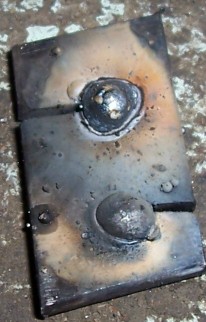

Here's the result of a failed weld

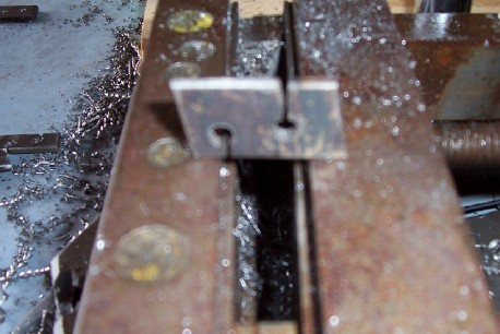

Here's the plate off the failed weld
I tried it a few times with no sucess.
The plates are held on with super glue and I dremelled out the hole and stator really well, all surfaces were shiny but the weld won't hold on the stator.

Sorry Highlander, it would be an alloy. Makes the iron/steel many times more useful as an electromagnetic material. Anything much above 2% silicon gets hard to weld.

Sorry to see this welding fail as l have done all sort of welding for many years as l am fitter and welder and do alot of maintence repair in the past and now l can see where this have gone wrong is your gasless mig welder unsuitable for this kind of work is lack of currect you need is to upgrade is buy good quautily welder maybe up to 150 amp with approx 34 volt no load and useing migshield gas can do spot welding at high power in 1 second instead of flux core is wasting your time and l hate it after seeing people buy this toy welder and l had to keep my mouth shut until they learn and find out later. Anyway l do understand is cost you money to upgrade the machine unless you know about how to welding ,welding theory and time of practice is learning however if you able to hire good mig welder but still cost $$$ again what about using gas flame welding with low melting point silver solder if this fail go and see someone in metal place who does welding work some have spotwelder, laser welding is the way go anyway let me know l might able to help you out

Dywer, thanks for your help. I know it's a crappy welder but I got it because it's light and can be thrown in the ute and run off my gen to fix gates around the place.It's fine for that sort of work.
I know of a metal working place in Melb, probably best to handball this job to a pro I think.

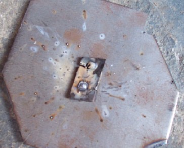

G'day again, I just don't understand why it welds onto plate steel fine. I did this one and tried to belt it off with a hammer and drift but it won't budge at all.
Due by lack of penetrate and lack of high welding currect and if you keep is going like this is wasting your time

G'day guys, after I got off the forum this morning I took it to a metal fabricating place in melb.
The bloke there said exactly what Dwyer said.
He had a 200A mig and cranked it up. He did a few test welds. when it cooled off by the time I got home I gave them a wack with a file and they all popped off like mine. But they did hold a lot better. He did one with a tig welder and that held on fine but the whole plastic former caught fire and completely melted. The windings on there looked screwed too.
KiwiJohn, Thanks for that but no experience in that area. I'm also worried about getting it too hot, that stator core is a bloody good conductor.
