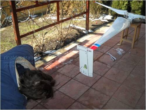

Yesterday I made some tests with my turbine.
I start from 4 deg AOA uo to 20 deg.
Guess what is the optimum?
Watch and enjoy!

Paradoxically, but the best angle is ...17 deg.
We have tested the turbine on both directions, charging at 12V and 24V.We measured rpm-s and the charging current.
At <10 deg AOA, the turbine has a hardly start and poor performance.
You can imagine the show on the street and the behavior of the other drivers seeing what we did.(Some reactions:"Yess, you don't need fuel any more", "New hybrid car?" )
The difference is now visible:Now I have more than 75% power at the approximative same wind speed.

Where are you measuring the angle of attack, at the tips?
rinaldoparaipan
Joined: 18/03/2011
Location: Romania
Posts: 21
Posted: 08:39am 24 Apr 2012
Yes, the angle is measured at the tip of the blade.
Posted: 01:03pm 24 Apr 2012
That is a lot of angle. It means the turbine isn't big enough to drive the alternator at its potential output. You need a lot of angle to get the torque, and make some usable power at low RPM. You would find if you changed battery voltage you would use a different angle, its all about matching the turbine to the alternator and battery voltage.
But, it is making more power that it did before. So unless you want to change turbine/alternator/battery voltage, I would say you've tests down the road have found the sweet spot for your existing combination. Thats good.

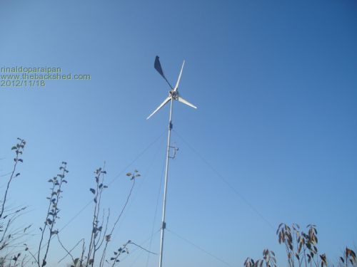

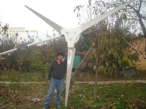

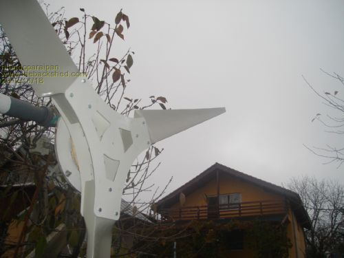

After a lot of tests and calculations, discussions. etc I have a real turbine.
Yesterday at a 2m/s wind and 56rpm I had 6A charging(my system is on 12V).
The new blades are manufactured based on Hugh Pigott details, but with a small improvement at the chord profile.The diameter is 4,2m.
I'm waiting for winter winds!!!
Unfortunately, the old glass fiber blades(3,5m diameter) were not able to produce what I expected and causing me a lot of disappointments.
It seems the profile is not the best one.Hugh told me that the blades are slower compared with his blades and he was right.
