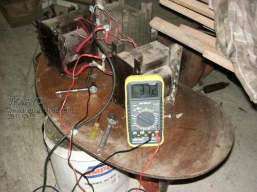

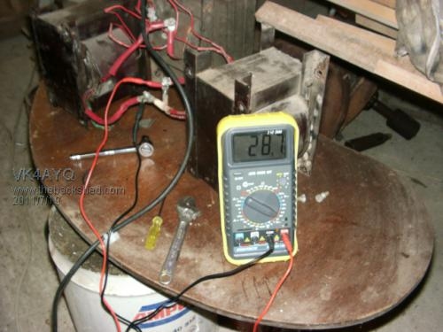

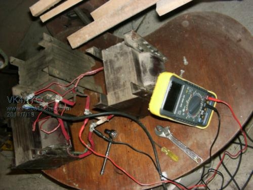

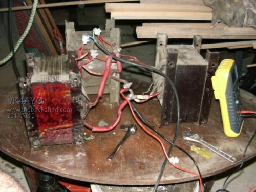

Posted: 07:19am 19 Jul 2011
Hi All
I did some preliminary testing today on a transformer coupled set up, still in the lathe as before and with 30 meters of 1.6 mm power flex lead.
RPM---- delta AC---delta dc - AC star ---DC star
40 ---- 1.0 ------ 1.45 ----- 1.70 ----- 2.5
52 ---- 2.2 ------ 3.20 ----- 2.80 ----- 4.0
67 ---- 3.2 ------ 4.60 ----- 4.06 ----- 5.8
88 ---- 4.5 ------ 6.50 ----- 5.70 ----- 8.3
113 --- 6.0 ------ 8.70 ----- 7.60 ----- 11.0
147 --- 7.8 ------ 11.3 ----- 9.90 ----- 14.3
190 --- 10.3 ----- 14.9 ----- 13.0 ----- 18.8
247 --- 13.4 ----- 19.4 ----- 17.0 ----- 24.6
320 --- 17.2 ----- 24.9 ----- 22.2 ----- 32.2
415 --- 22.3 ----- 32.3 ----- 28.3 ----- 41.5
540 --- 29.0 ----- 42.0 ----- 36.9 ----- 53.5
700 --- 37.0 ----- 53.5 ----- 47.0 ----- 68.0
The above figures are running without load I will hook it up to the batteries tomorrow if time allows and do some load volts and amps testing into the actual batteries.
All the best
