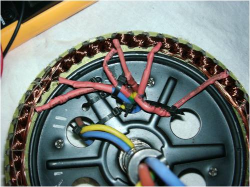

They are connected in STAR as original, here is a photo of mine reconfigured as Phill suggested so the terminals are under the front cover so all thats required is to remove the front to have access to the windings.
access
The termination of the windings is on the rear side of the stator, these wires are lengthened and fed through the holes in the stator to the front to the terminal block so they can configured as star or delta as required.
I think from memory there are sixty coils wound five wires in hand.

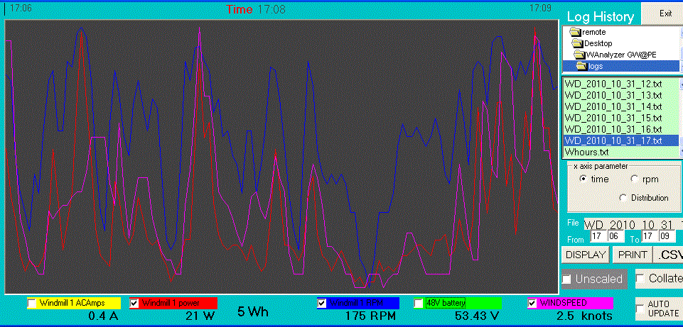

Posted: 06:54am 31 Oct 2010
Hi Bob,
here is a graph of a few minutes logging of my mill at 2 sec intervals. I think an electronic controlled actuator for furling based on rpm will wear out quite quickly.
Dampening the system will negate the furling benefit.
Gordon.

I see what you mean, the rpm is all over the place, looks like I will have to go back to the high voltage fixed maximum amps Idea, as its the amps thats doing the damage on extended power intervals. If I set the maximum amps at 40 amps that should be sustainable within the design of the generator and let the volts climb then down switch to 27-6 volts for the total power.
The furling is also critical to prevent a full runaway.
