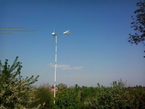

Today I have tested this device wich allows to set the optimum rpms/amps ratio for the turbine by adjusting(manualy for the moment)the duty-cycle.
Don't blaim me about the PCB-it is just a prototype.
The results are very good, i have to solve the automatic duty-cycle adjustment,may be @jean can help me.
Tomorow I will show the schematics.
