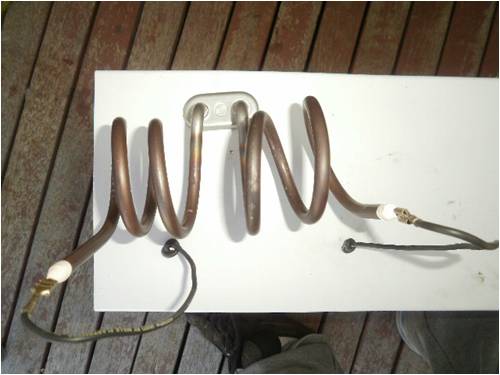

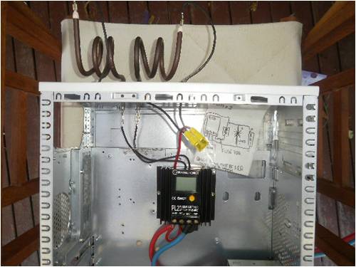

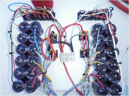

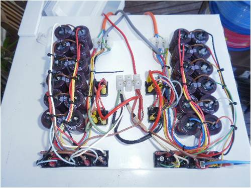

Blade balancing tomorrow.
had kids today but got these almost finished.
House end dump load and voltage controller
and
and about the 5th iteration of the volatge doubler

Karl , Make sure the diode that is supplied with the pl20 is used accross the output to the dump load and orientated correctly or you will be up for another pl20. Looks like its almost ready .

Hi Karl,
I try and keep the wire interconnect lengths as short as possible. Here is a link to some pics of my arrangements. doubler and trippler
looks good though all loomed up.
Gordon.

Posted: 11:01am 16 Nov 2009
Phill
diode is there, I wrapped 80% of the conductors in heat shrink so it couldnt touch anything else in between and the two ends go into the terminals behind the wiring you see.
Gordon
I figured as they are carrying minimal current it wouldn't be that critical. If its 20%max then we're talking 120W split over the three phases, split over the two sets of caps, so I assumed they'd carry 20W or so each, even if its 60W each @48V or better we're still talking very little current.
If its that critical perhaps I should solder all my links instead of having connectors.....
Karl
Posted: 12:51pm 16 Nov 2009
Hi Karl,
I have posted DSO pics of output waveforms. There are high speed switching spikes associated with these arrangements. All wiring is a potential antennae and you should keep all interconnects as short as possible. There is enough RFI out there, without unnecessarily making more. The power handling is not really a player here.
Gordon.

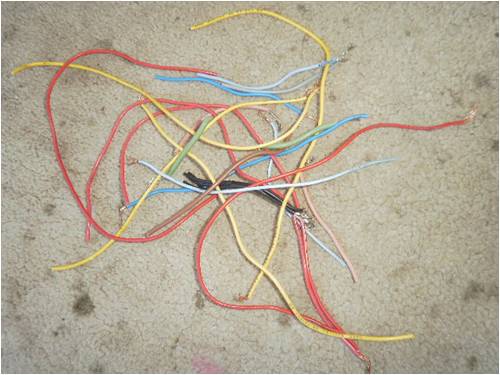

Posted: 07:03am 17 Nov 2009
Ahh Gordon, what would I do without you.
The inputs were originally elsewhere and I didnt think I'd bother
here is the excess wire cut out
here is iteration 7 (and the last- remaining wire is tough)

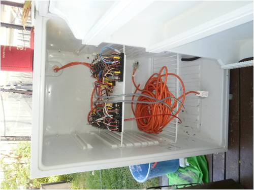

Last ....wait for it....the faraday cage!
(also known as a fridge)
Revolutionary in wind turbines I reckon.
wire bundle at the bottom is the wire that will run up the tower.

Hi Karl,
old fridges are good for all sorts of purposes. I use one to store kindling. Is a normal 500L cabinet though.
I was a bit short with space in my metal enclosure, as I have many more caps. I tend to use enamelled winding wire, for the fixed interconnects. I use flex for the external connections only now. I have my trusty SS long nose pliers that are perfect for removing the enamel prior to soldering. Wire that I would have just recycled makes good short interconnects.
You seem to have things well sussed now.
Gordon.

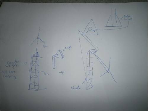

now need to concentrate on getting the tower up....
working bee anyone?
Have to take down next door neighbors windmill,
was a southern cross, fairly small tower three legs about 1m apart at the base work out how to add on up at the top a hinge mechanism.
needs to be a self supported rig.
This was my idea
Karl
most of the construction is incredibly light, i'll probably replace the wire cross pieces with angle steel.
Edited by KarlJ 2009-11-18

Phill advised that the 680uF 450V caps were the best for our 80 series in 2x7c wiring rather than the 7x2c you have now for 12V. Obviously works for this setup at 48V+
Trick is one step at a time. print out the schematic and label your rectifiers 1-4, start soldering and or crimping until all the connections are done.
split your caps into phases ie 4 for each phases and wire one phase at a time.
when there are no connections left to do you're finished.
I mounted on a piece of steel cut from the side of an old microwave as its powdercoated and works as a heat sink too (not that I think they will generate much heat as everything is sized too big). I think we all wish our 35A rectifiers werent big enough!
35A x2 for main power handling (again not sure if it quite works out this simple but)
70A at say 55V = 3850W.
given mine will probably only see 4-600W max they should barely even see a temp rise.
I would like to see a circuit for the triplers so I can build that too and perhaps buy enough bits to make 4 doubler/tripler arrangements to economise on the components (postage and such)
and then sell at component cost +say $40 to keep the missus off my back.
That way I could sell them to forum members and would work out cheaper than them buying just the bits to build themselves.
also I guess doubler/tripler starting to look pretty busy and may be a little much for some.
Problem with this theory (making a few) is that this combo of caps works best on an 80s in 2x7c so what for the other combos, will probably work well enough but Gordon's baby he would know.
