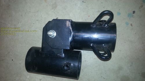

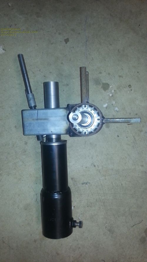

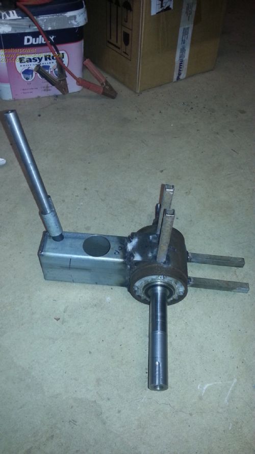

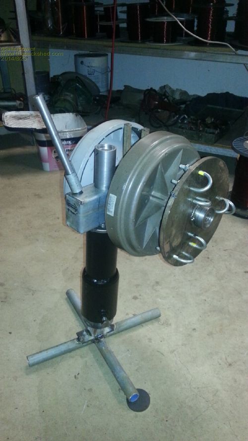

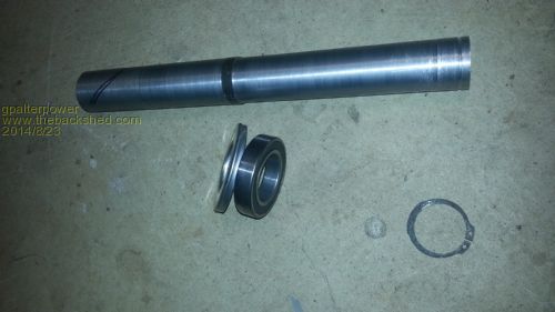

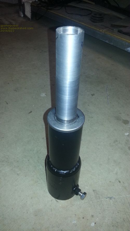

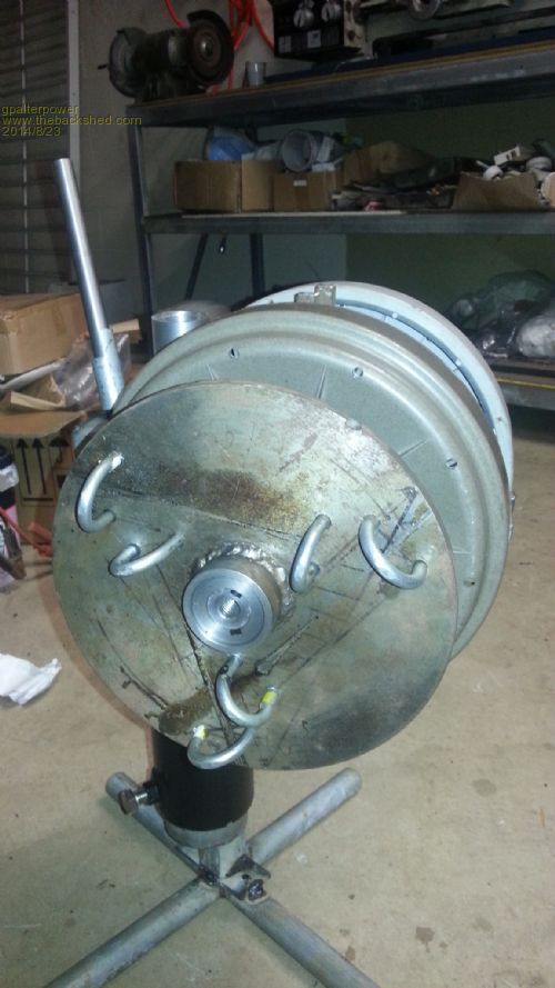

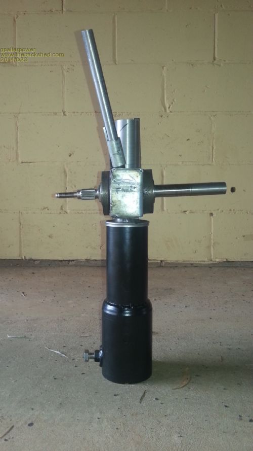

Well Ive been away for a while but now im finally going to finish the dual mill I started years ago. Ive used most of the original parts I manafactured and made a few changes but nothing is set in concrete yet as the whole thing is just tack welded together.The first pic is an attachment that sits ontop of the tower. It houses a 40 mm thick walled hollow shaft suported by 2 6008 bearings. The nacel sits upon this.
It is made up from the following parts
The bearing mounted tube is secured on the base by a circlip which holds everything from falling apart when hoisting the mill in the air.

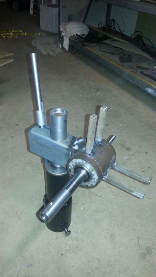

The nacel is the heart when it comes to fuling so I believe its critical in dimentions. I made the distance from the tower shaft and the turbine shaft 100mm which is tilted up at angle of 5 degrees. Not too sure if these are correct or within tolerances, but im going on previous posts and pics. Any input to this would be greatly appreciated
And with it assembled. The 2 sets of 13mm rhs poking out are for a cowling that im going to fit later on to protect all electrical components.

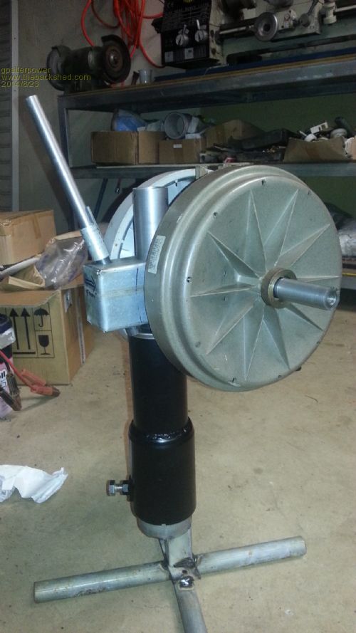

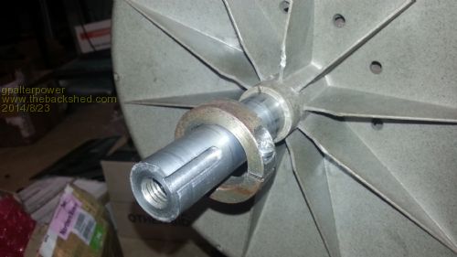

The rear flywheel is attached in the normal manner. The front is a little different. I machined a section away and fabricated a ferrule to slip over and tighten to secure to the shaft. The blade hub also sits hard up against the ferrule.
And with the blade hub attached. A 6mm key and 12mm bolt in the front of the shaft to drive the mill.

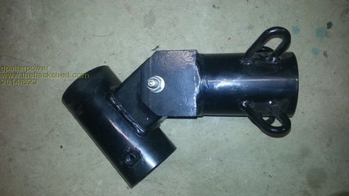

This is the hinge that sits upon the first length of 75mm pipe which is concreted in the ground . the second length slips thru and pivots the mill to about 8.5 metres in the air. The four half chain links are for the guy wires

brucedownunder2
Joined: 14/09/2005
Posts: 1548
Posted: 10:23pm 22 Aug 2014
Hi Marcus. Nice work mate .
You must have gone to the same tech college as Phill,lol.
first ,why are the "U" bolts not in line ?
second, I like the fabrication , cover the rotors, they don't like UV.
Yep, I know you know this,lol.
I made a dual , still have it ,one day will put it together again ,along with the LG stuff I've got waiting ---- my workshop is like a doctors waiting room --next please !!.
Bruce
Bushboy
Jarbar
Joined: 03/02/2008
Posts: 225
Posted: 10:54pm 22 Aug 2014
Bruce,
I think the idea is for the blade shafts to pass the generator axis which transfers the the blade torque and clamping load across the whole plate instead of just the edges.I have incorporated this on some of my designs as yet unfinished.I think I've been out of action for a similar period unfortunately.I agree he has made an excellent nacelle assembly.
Anthony.
fillm
Joined: 10/02/2007
Posts: 730
Posted: 12:55pm 23 Aug 2014
Hi Marcus ,
Looking like a nice build so far but I think I have seen that bearing housing and frt rotor idea some where before.
Anyway you seem to be getting back into the swing of things but still have a way to go . I personally do not like configuring blades that way as the centrifugal force now acts as a giant lever on the outer clamp and when the blades gets going in a good breeze its to easy for everything to go pear shaped. Hey but just get it in the Air and fix things when and if they break.
Keep us posted , it is just good to see someone doing something !!! Edited by fillm 2014-08-24
gpalterpower
Joined: 19/07/2009
Posts: 177
Posted: 03:49pm 23 Aug 2014
Morning all and thanks for the comments. When I first made the hub I only had acces to a fairly small lathe and the maximum dia I could turn was 250mm. So I had to think of a way to somehow fit 3 shafts on to that plate. A cross hatching idea was the best I could think of which is why it looks like the "U" bolts dont line up.I did not think outside the square when it comes to pivoting on the outer clamp. There may well be issues down the track and I allready have some plans in the back of my mind how Ill make the next one, but for now ill run with what I have. There could also be an issue with using the original shaft driving 2 rotors as well as the hub. A lot of twisting forces on that 25mm shaft. hope it holds. The pic from my earlier post below shows the shaft configuation. regards Marcus
if it aint broke dont fix it!!

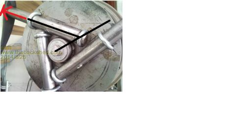

Tinker,
I think you are on the wrong track, if the blade outer clamp was removed and the inner clamp could pivot freely then the weight mass would want to swing out until it is at its balance point radiating out from the center, this would still the same for driving an alternator, and yes you are correct here, seizing & braking would amplify this load.
The leverage force ratio on the outer clamp would basically and very roughly be the distance between clamp x distance to center of the mass of weight in the blade but I am sure it will much more complex than that in a true mathematical equasion .
As it rotates the outer clamp takes this load factor and I would think at 600RPM if the blade tube if it not strong, then would want to start bending if not already.
I would think the original intention was with only small light blade & hubs being able to have well spaced clamps to hold the blades .
Airflow or blade performance should not affected as the blade is still at the same AOA and faces the wind as it should

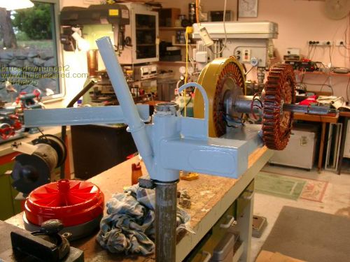

This was my set-up for a dual some years back . The yellow rotor was fitted with Neo's. I think the red one was also , but during fitting I dropped it on the concrete driveway and swore a lot --that ended that project.,lol.
But the neo's sure did give more power.
That hub was an aluminium casting from Trev . Very heavy duty, trev makes excellant stuff. That's aircraft grade Al,tough as.
Bruce
Oh, sorry, the hub is not shown ,,I'll dig it up
BruceEdited by brucedownunder2 2014-08-26
