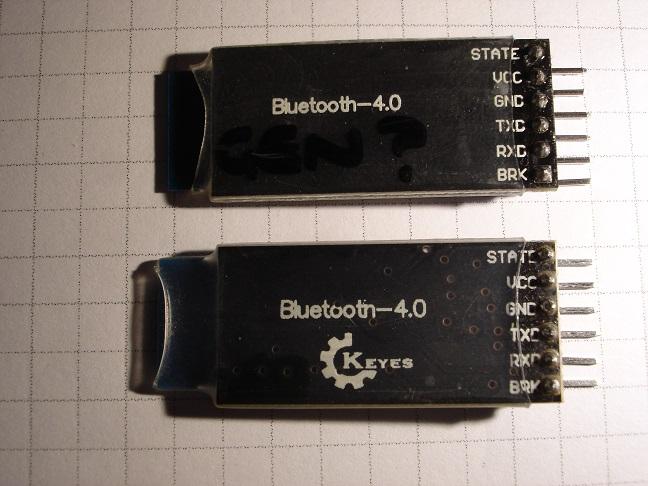

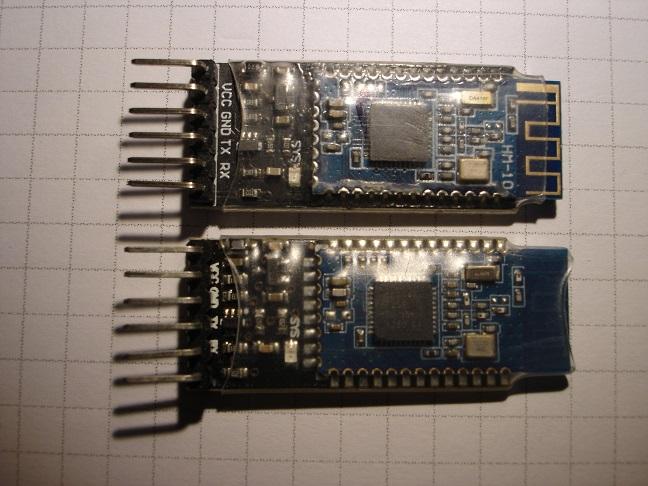

G'day Peter,
Some further testing of Bluetooth serial and both HM10 modules are working after AT+RENEW to reset factory settings.

HM10 Modules:
I am reasonably certain these where purchased at the same time from the same shop, however it is also possible there are more here that have been mixed in and muddied the water...
Upper module in Pics:
HM10 - 1 Possibly genuine?
Chip marking - CC2540
AT+VERS? = HMSOFT V610
Most AT commands work
Lower module in Pics:
HM10 - 2 Possible fake?
Chip marking - CC2541
AT+VERS? = HMSoft V203
Few AT commands work but this is a very early version if VERS? is correct.
