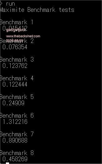

Posted: 06:50pm 08 Jun 2026
Here is the benchmark speed test for the esp32-s3 version of basic.
I am happy to get some use out of those boards that were wasting time in my bench drawer.

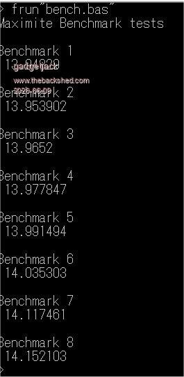

gadgetjack
Joined: 15/07/2016
Posts: 240
Posted: 10:38pm 08 Jun 2026
Ok , I used [frun] on the bench test i posted before. pretty big change....
Jack
