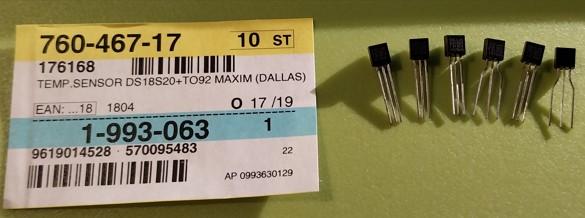

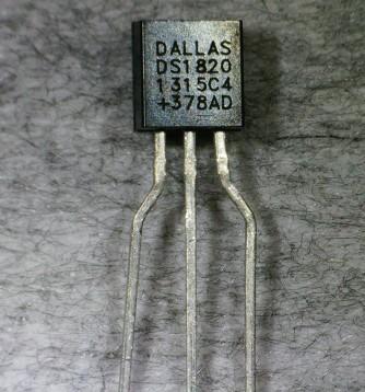

Peter63
Joined: 28/07/2017
Location: Sweden
Posts: 220
Posted: 01:44am 30 May 2026
photo of the DS18S20 marking used during test
/Peter63

The COUNT PER °C scratchpad is supposed be always 16 with the DS18S20 but Peter has a DS1820 according to the photo.
Are you sure that COUNT PER °C is always 16 with the DS1820?
I don't have either chip to test with.

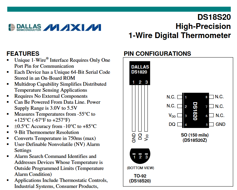

Jim, you are right, as you were writing that I was reading the Dallas DS1820 datasheet and COUNT PER °C varies according to an internal calibration table.
I will incorporate that and ask Peter63 to test again.
The saga continues...

I thought I had a DS18S20, according to my saved label, but now it doesn't seem to be so.
Happy to test further...
Edited 2026-05-30 14:01 by Peter63

CpC staying on 16 is what I would expect for a DS18S20, not DS1820.
The rate of change of temp. is so high it is hard to tell what the decimal part is doing.
To check that ideally we need a very slow change over about 2°C, while displaying T3 to get as much fine detail as possible.

Could it be DS18S20 that I have, but maybe they are mislabeled?
Peter63
Joined: 28/07/2017
Location: Sweden
Posts: 220
Posted: 04:59am 30 May 2026
new test...
Temp = 23.4`C

Posted: 05:08am 30 May 2026
Thanks to Googles AI,I found another datasheet that suggests that the DS18S20 uses the same die as the DS1820 so has the same markings "DS1820"
That's bloody helpful!
I never trust the BS that Googles AI spits out but it might be right this time.

Feels like it would be so Dallas Maxim, the variant is also TO-92 which I have.
/Peter63
