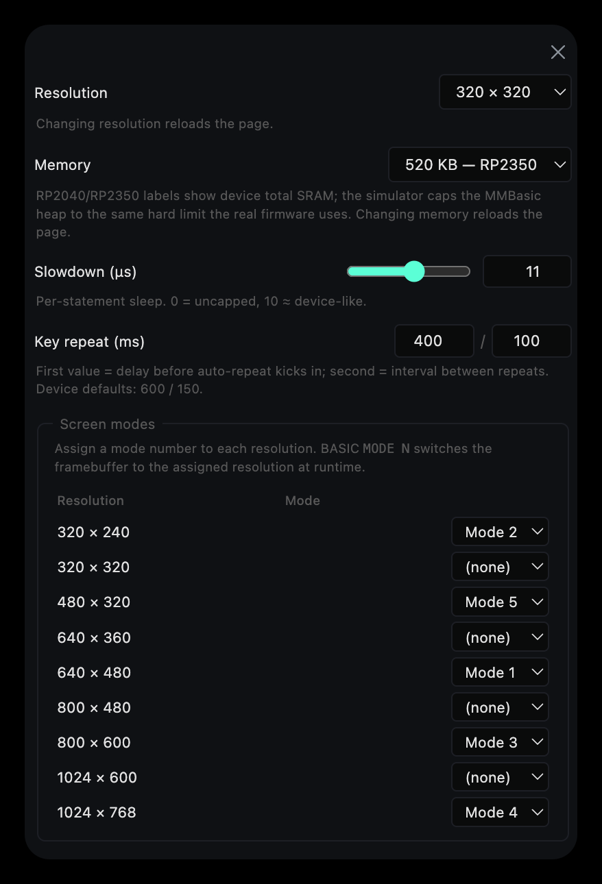

Is it possible to set additional modes? For example, the RP2 HDMI supports several modes at 320x240 and 640x480, just with a different bit depth
The mode mapping is in the config
It doesn't really address bit depth, and I am don't remember what bit depth the simulated framebuffer is, but I think it's high, 16 or 24 bits.

  Quote  It doesn't really address bit depth, and I am don't remember what bit depth the simulated framebuffer is, but I think it's high, 16 or 24 bits.
Yes, I realise that, I may have expressed myself badly..
I was thinking of a way to choose between several modes for a given resolution
