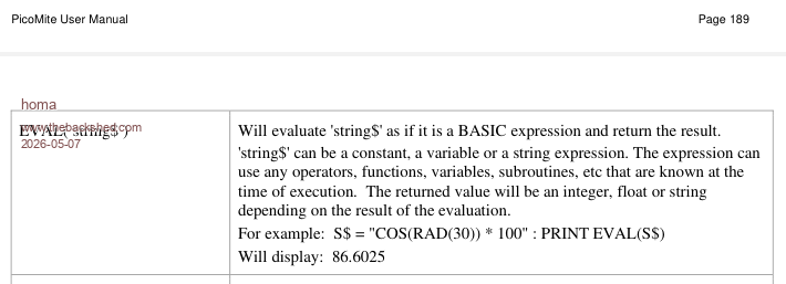

  javavi said  @matherp Peter,
Since things are moving forward, can I ask too?
Is it possible to make a built-in calculator for PicoMite, using the CALC command?
A calculator like the one in PicoTop
https://github.com/7west/PicoTop
Please don't ;-) Why else do we have BASIC for writing our own programmes? ;-)
@javavi: This command is very interesting for that:
Matthias

Mini example, without error handling, without parsing the input, etc.:
CLS
Font 1
Dim integer r%
Dim string  i$
 Input "Calc ";i$
 r%=Eval(i$)
 Print r%, Hex$(r%), Bin$(r%,16)
Loop
Calc ? 2+3*4
14     E       0000000000001110
Calc ? sin(pi/2)
1      1       0000000000000001
Calc ?

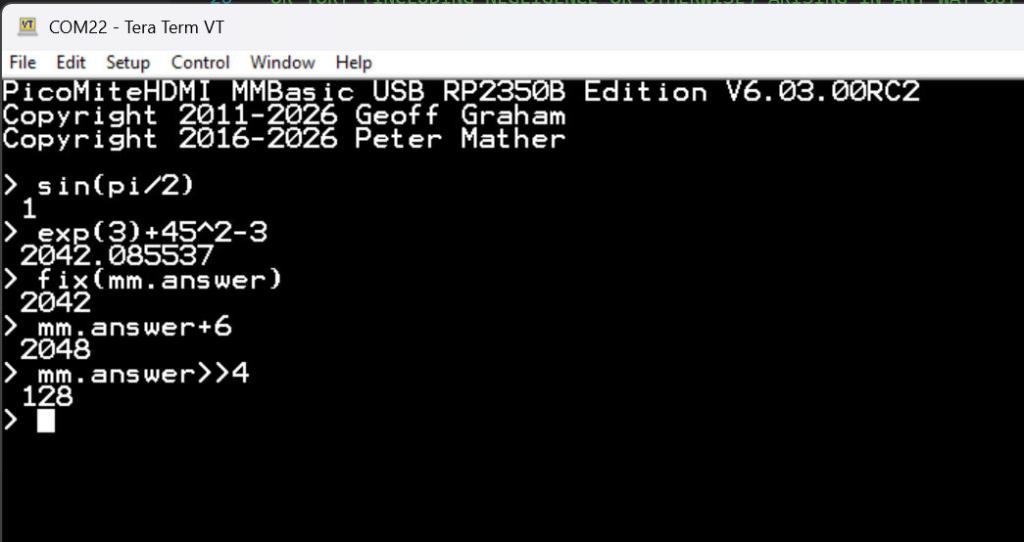

V6.03.00RC3
PicoMiteRP2040V6.03.00RC3.zip
PicoMiteRP2350V6.03.00RC3.zip
Listing a short file in FM now requires a keypress before exiting the listing to avoid it disappearing immediately
Expermental add-ons
All versions:
Calculator immediate mode at the command prompt. Type in calculations and you will get the answer no need for a question mark. The answer will also be stored in a variable MM.ANSWER allowing follow-up calculations. This code is 1: trivial and 2: only gets executed after all normal command line processing has failed, so it should be benign and I will certainly find it useful as well as hopefully javavi

Peter,
occasionally I get an error in the new calculator mode, e.g.
> sqr(2)
Error : MM.ANSWER is not declared
can dim mm.answer as integer, calc-mode works then and it turn up as a float variable which makes sense.
Currently I'm not able to reproduce it consistently.
Env.:
PicoMite MMBasic RP2350B V6.03.00RC3
Edited 2026-05-07 22:13 by ville56
73 de OE1HGA, Gerald
Posts: 12173
Posted: 12:50pm 07 May 2026
Caused by OPTION EXPLICIT - easy fix for next RC
