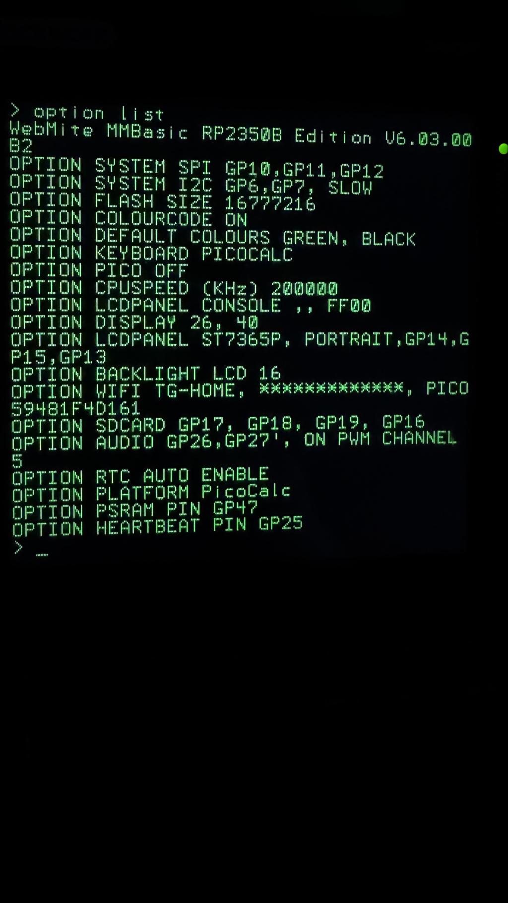

I lowered the CPU speed to 200MHz, same problem.
Options attached.
If I put End before json$ the program stops normally.
And from command prompt I can print json$, but in the program causes restart.
